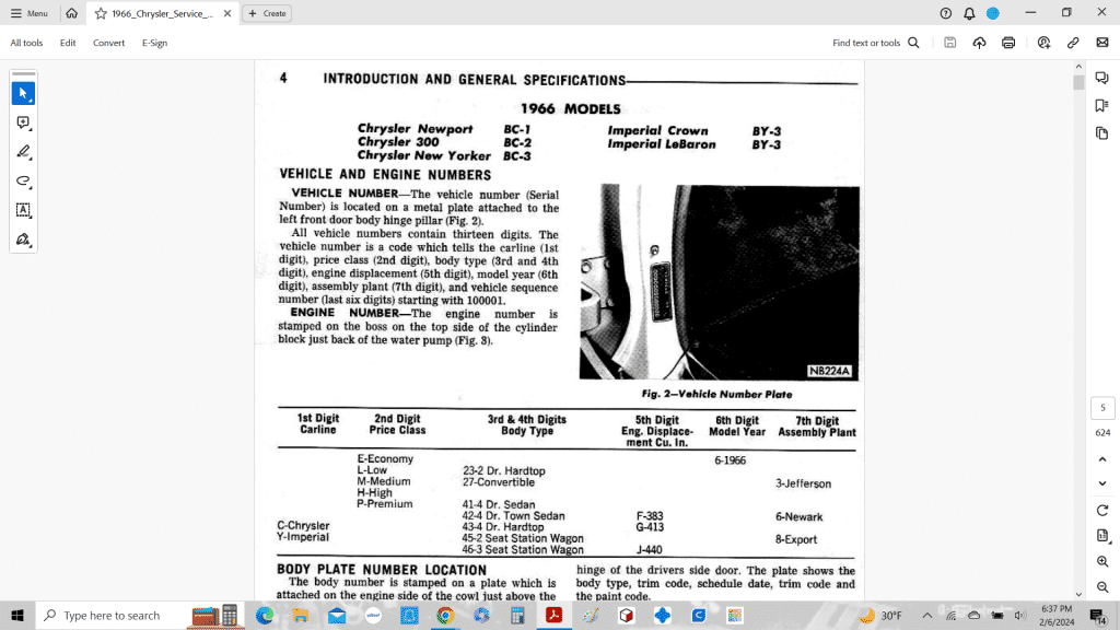

Your book is wrong. I'm not sure what reference book that is, but the engine codes etc. can change from year to year. Download a real factory service manual here: MyMopar
Screen shot from the 1966 Chrysler Factory Service Manual:

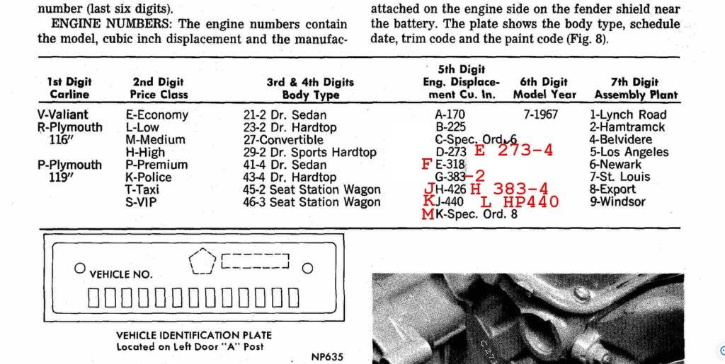

I don't know about the 66 Factory Service Manual but the 67 Factory Service Manual is full of errors on the engine VIN codes
Alan
Does the '67 Chrysler parts book have an accurate VIN engine decode for ALL Chrysler cars, not just C-bodies?
For 1966 J code is 440.
K was used in later years for the " lo-po" 440, 67 and 68 if I remember correctly.
I don't have access to a 67 Chrysler book but both the 67 Dart/Coronet/Charger and the 67 Polara/Monaco books have it correct.
