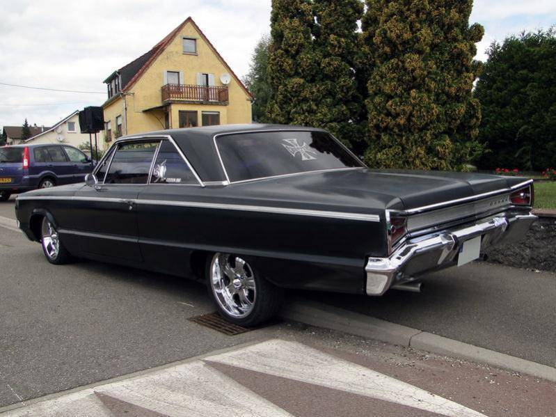

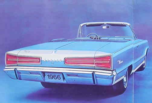

65 rear bumper wont fit a 66 only things that interchange are dashes,doors,and maybe glass...to different animals....DAMHIK....JOHN The 65 rear bumper corners flare out to match the taillites ...the 66 is flat all the way across to match there taillites
Heres the diffrence..also looks like quaterpanels might work but good luck finding those JOHN. 66dgmon2.jpgdodge-challenger-conv-4x4-05.jpg
