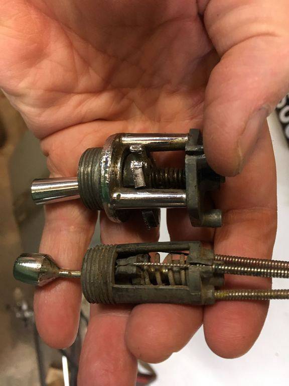

I think that the difference is the inside controls. I know they changed somewhere around 66 or 67... My 65 Barracuda and the 65 Chrysler mirror I bought for parts, have the larger control. I think we may have figured this out on another thread, but I don't recall.
The second link in my post is for a matching, non remote, right hand mirror.
Larger '65 control versus the smaller (this happens to be a '70) control. The larger style has to be disassembled to install in the door. I've never had the smaller version apart.
So the toggle is different. That would be obvious. How hard is it to take apart?
So the mirror itself is the same size A,B and C bodies, and 65-66?

Never took the big "toggle" apart, so no idea on that. Small toggle is easy.
Yes, same across the board A, B, and C
