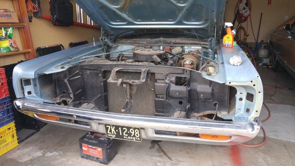

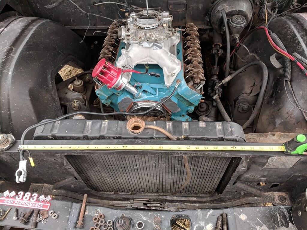

Heres my 68 Fury with 383-2 & factory ac, 26" with shroud and clutch fan

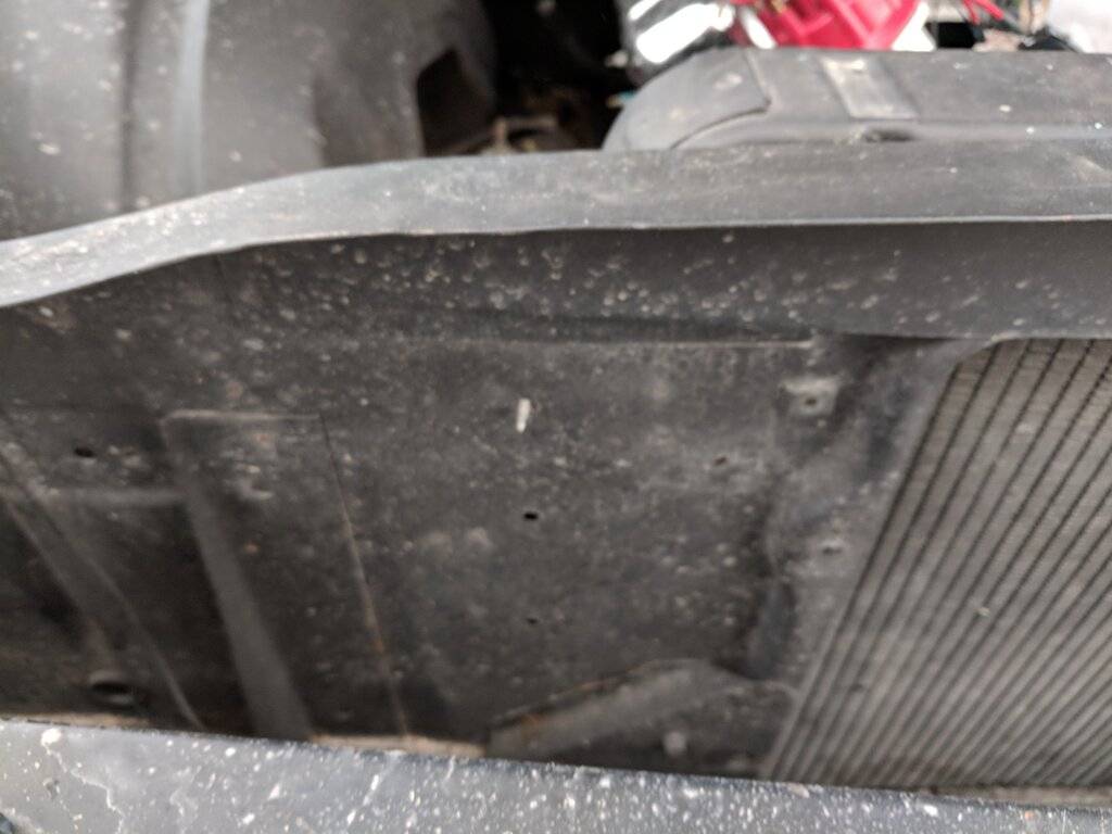

That does not look factory to me...
Area 1 - The notch is not extending all the way to the right
Area 2 - Note the color difference (vertical line)
Area 3 - looks like a welding seam, also, does radiator corner just hang in that area?
Maybe someone just opened up the support to accept a 26" radiator? Or that`s the way they did it at factory...
I just checked the parts catalog and it does show the 26" support part number for 68 Fury.

The color difference was likely due to the blackout treatment.

Will post picture of my 68, with 26-inch std (Newport Custom with A/C and 383).
I would be really good to see the pictures, especially passenger side lower radiator corner in relation to the opening.

It was very bad light with a poor phone camera, the outside of my car had a spray over in the 80's (factory colour), but they didn't touch the bay. I still have the build number in paint pen/chalk on the bonnet catch support and if you saw the car in person, you would have no doubt it was original
I have the build sheet - its a factory 26"

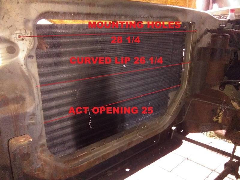

This is what a 26" radiator looks like in a 22" opening. Battery tray forces the extra to the passenger side. And no, I didn't do this, it's how I got the car.
