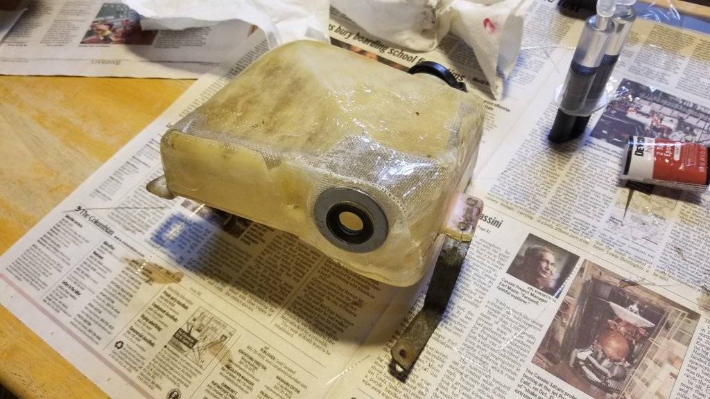

A little more progress on repairing the bottle. It's been quite a bit of work and still not sure if it is going to hold water. I need to put a couple more layers of cloth on before testing.

Nicely done. I was going to do a fiberglass repair. Did you just use something like the 3M repair kit? If not what did you use?
My friend built a teardrop trailer that used fiberglass cloth over plywood construction. He gave me some trimmings from the cloth. I am using a two-part epoxy from the hardware store. If I did it again, I might use a different epoxy that is thinner. It's been hard to fully saturate the cloth and I need more volume. I made a plywood/fiberglass cloth kayak from a kit once, and it came with epoxy from System 3 that seemed easier to work with. The cloth scraps and hardware epoxy has been handy though. I used it earlier to repair a piece of plastic from the interior. Convertible Fury - 1970
I already added the system 3 epoxy to my amazon cart. I don't know how I missed your Fury restoration thread thanks for sharing, now I need to go back to the beginning. :)

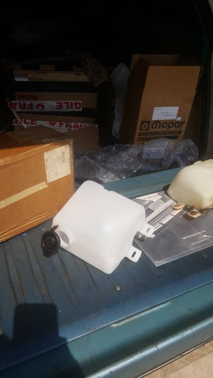

Got lucky today at a swap meet that doesn't usually have a lot of Mopar sellers. He had 2 NOS tanks sold one yesterday i got the last one there. And he had NOS 440 hood emblems also.

Called and talked to VANS today cause i was gonna offer to take the tank i just got to them and see if they wanted to try and repop them. He said no there is a guy that did them and they should be there at the end of the month i asked price and he said between 60 to 80 buck's.
Put that NOS on ebay for $599 and then buy the repop for $60....
Thought crossed my mind but i got the NOS one yesterday for 75 buck's i gotta hang on to it who knows if ill ever find another NOS one . I wanna see how close the new tanks will look im still trying to see if they will do 69 bottles.
