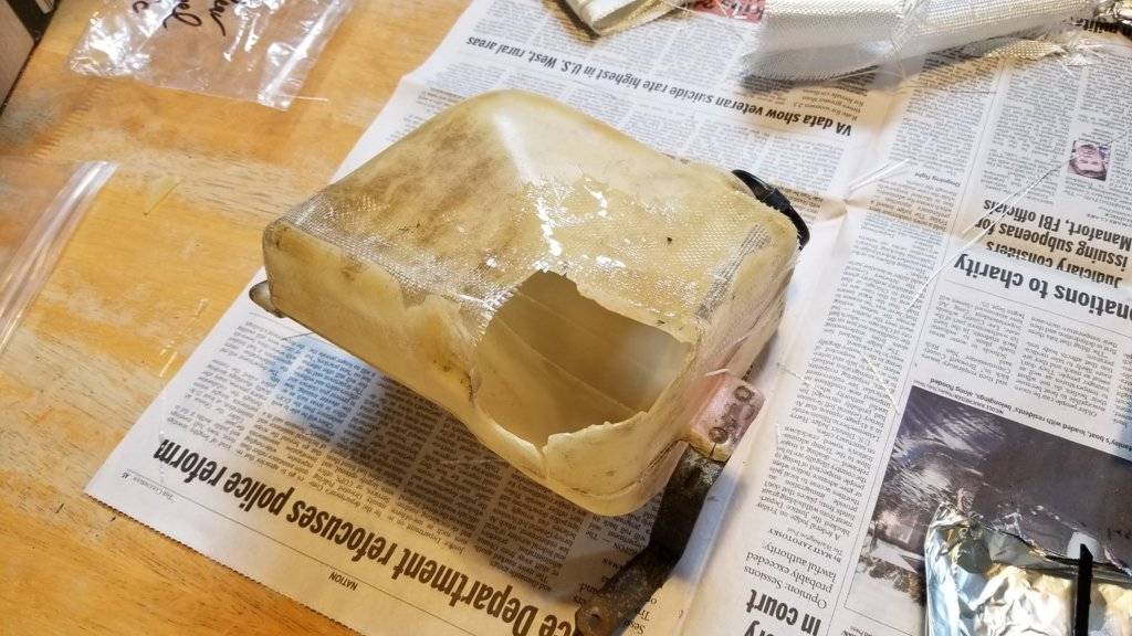

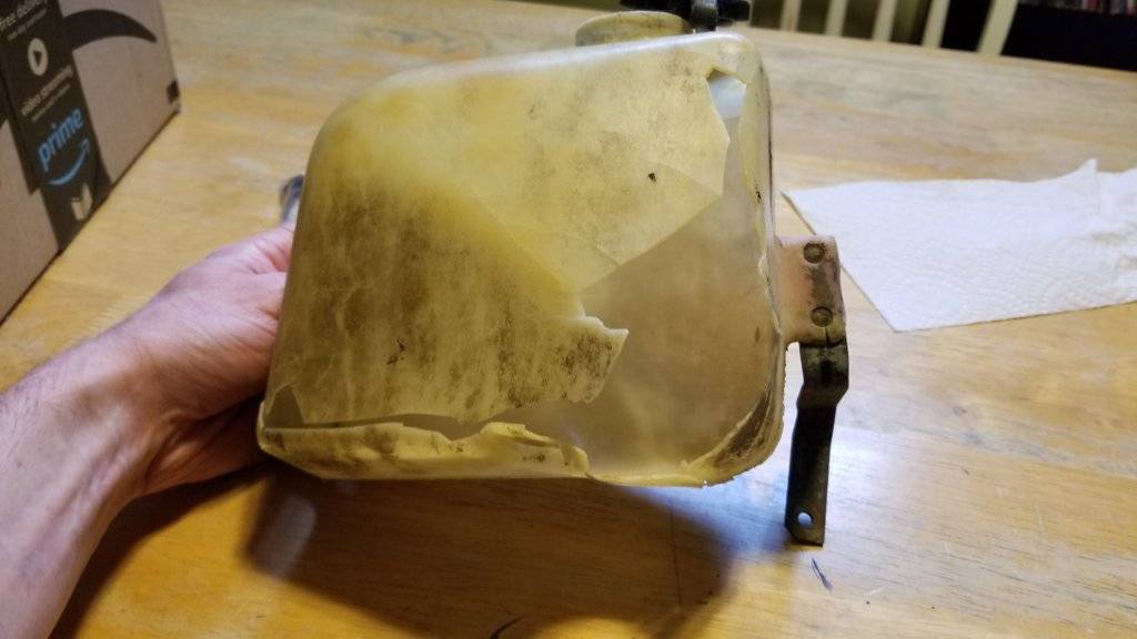

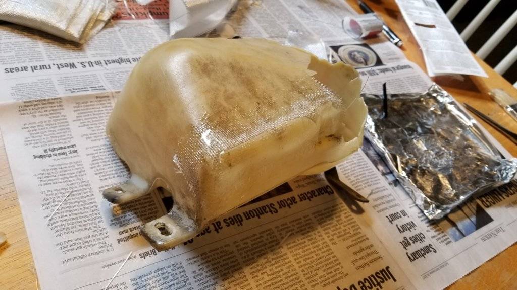

1970 Fury - I have not been able to find a reproduction for it. Here are some pics of the fiberglass patching. I've done two patches so far. The part where the pump connects will be tricky. I put the original rubber washer in a 3/4 inch stainless steel washer and will fiberglass it into place. Dunno of this will actually hold water but the epoxy is supposed to be waterproof. We'll see.

Yours looks identical to mine. Sigh
