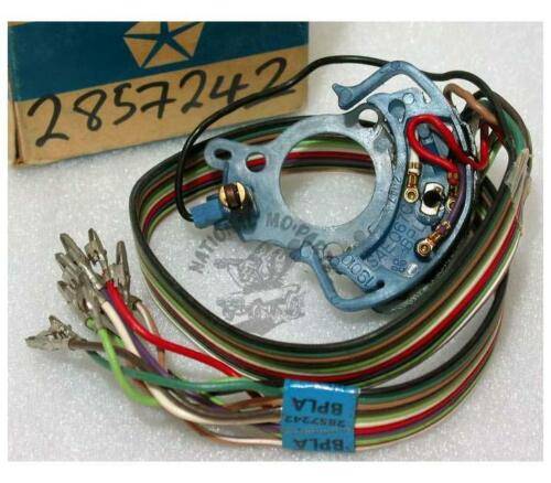

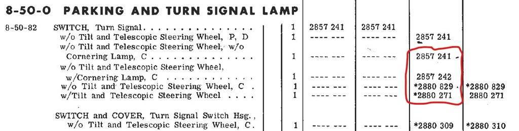

It does sound like the classic TS switch failure. You have to figure out what your car needs depending on options. You also need to look at the service manual to see how to do the job. Basically you have to disconnect each wire at the quick connector & then fish through the column, making sure you attach a string or wire to the wires so that you can pull the new wires through. If your back is good & you're agile you can do it without removing the front seat. Here are your switch options, most likely 2880829.
You never did mention if you had tilt-telescopic wheel.
If you are non tilt-tele you've got it made as replacements are plentiful.
Tilt-tele, there's only one option.
No tilt or telescopic. I saw one on amazon for about $65. But the bigger plastic piece that the TS switch screws to is worn too. Where can buy one of those?

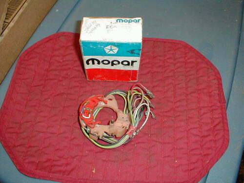

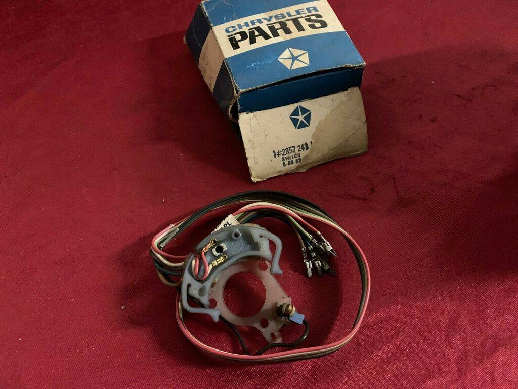

Is the body of the switch white or red/pink?
Different switches for different columns.
Non tilt columns were either Saginaw or Chrysler.
