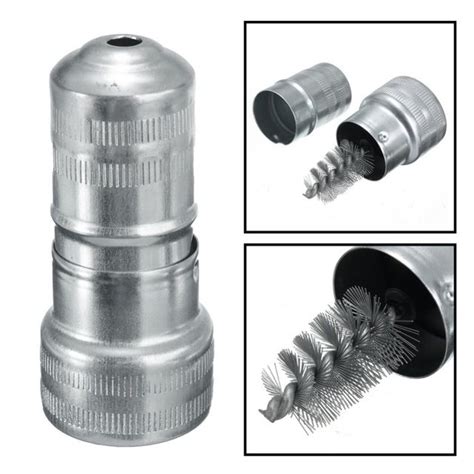

use one of these tools on the cable ends and posts.
I had the connector from battery to relay come loose on me one time. Looked connected, but not.
