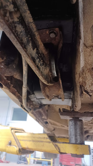

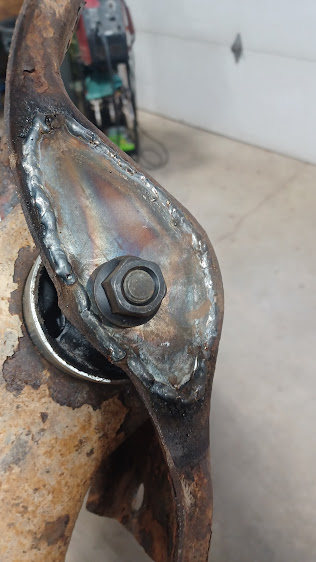

That’s very impressive all around!More rust repair today, my sons 04 Saturn Vue. The area where the LF rear trailing arm mounts rotted bad.

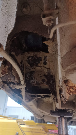

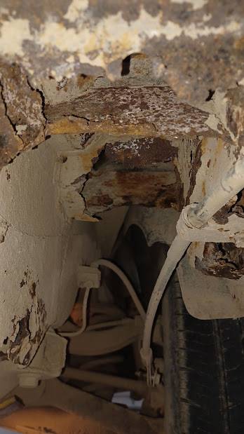

Some before pic's with the arm removed
Looking rearward
Looking forward

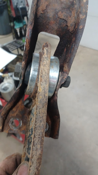

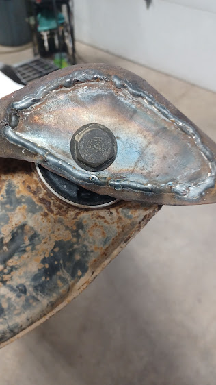

Reinforced the trailing arm bracket
New bushing installed

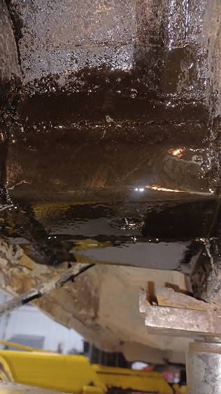

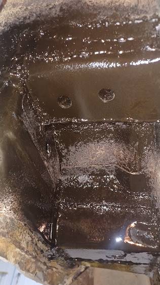

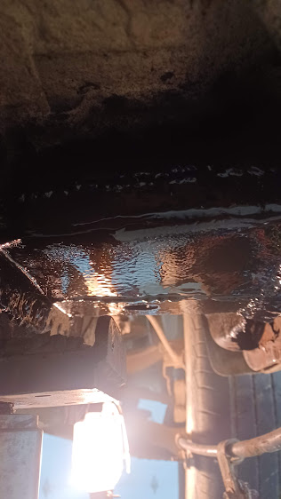

Fresh metal and undercoat, looking forward
Looking rearward
Trailing arm installed and ready to run
The rockers are rotten, but this will keep it running for the winter. He knows it's time to find a replacement. It has 301,000 on the clock, it's been a great car

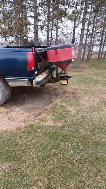

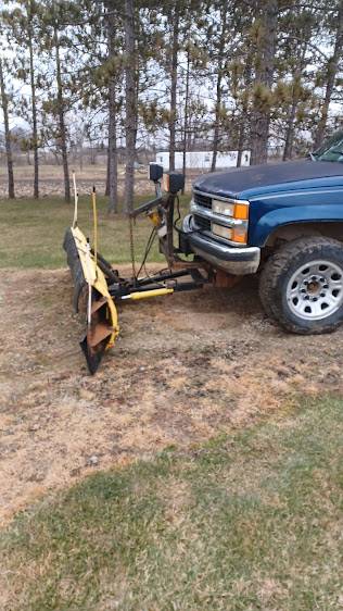

I need a plow for my truck.Snow is in the forecast for early next week so I got my plow truck ready. I repaired the LF side plow light and installed it, mounted the plow and salter.

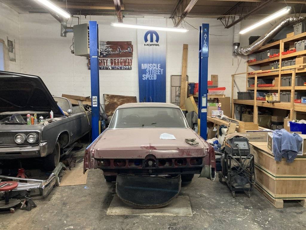

How are you ensuring that the posts are level and square/true?Started getting my hoist into position. Had to get creative with shims on the right post because it was between 1/16” and 1/4” lower than the left post.
I do everything with a builders laser.How are you ensuring that the posts are level and square/true?
