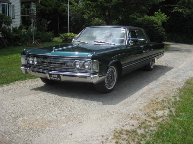

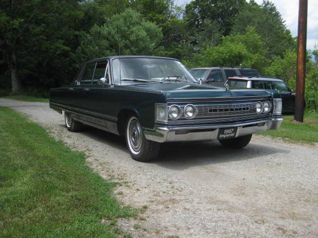

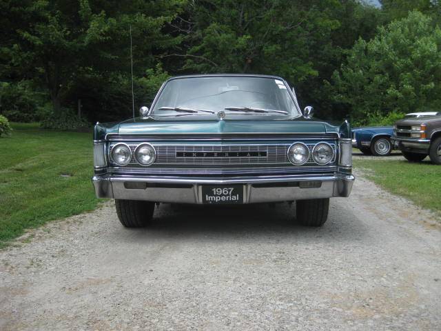

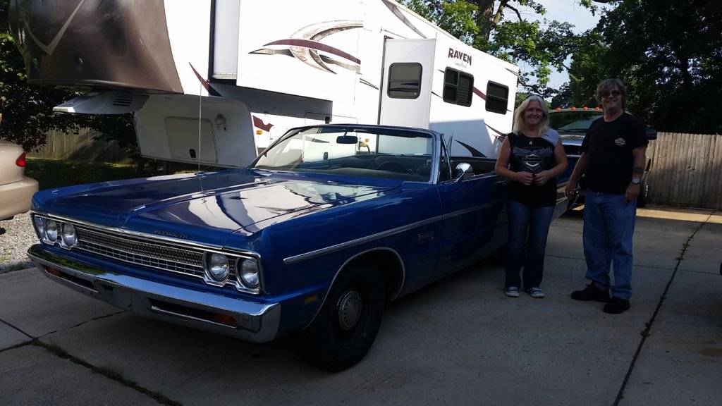

Well..... I sold it. New owners are driving it home to the Philly area this afternoon.... now I have a Carlisle car corral spot I bought 2 weeks ago and not going to use...

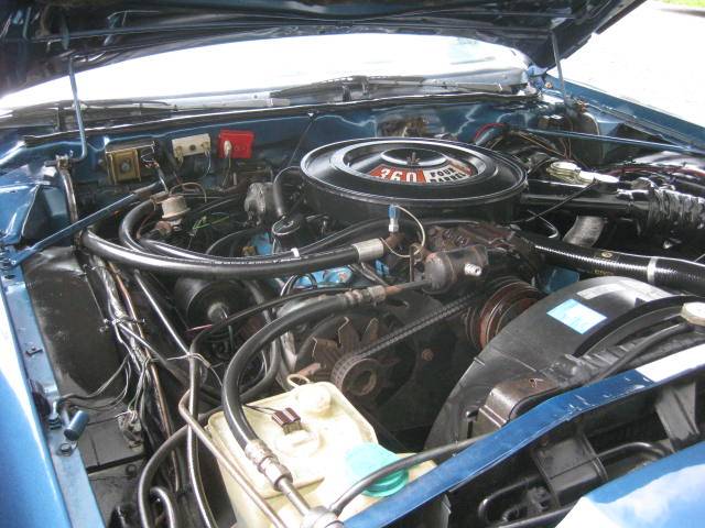

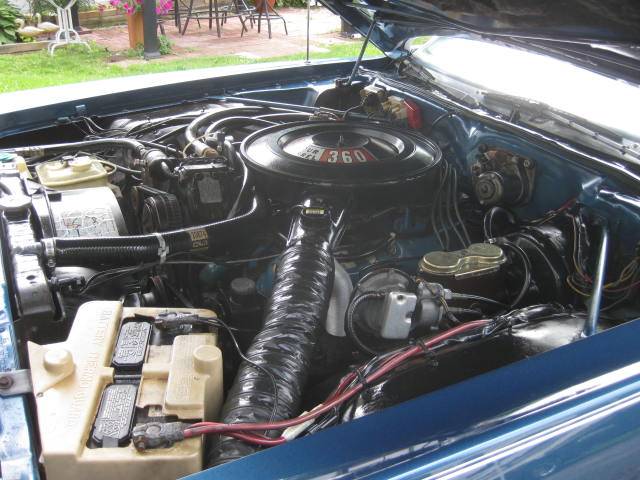

Couple things I did in preparation for Carlisle... Detailed the engine compartment

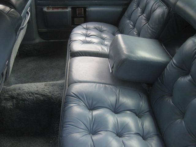

Also the interior

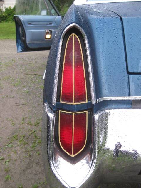

Everyone that owns a NYB knows what happens to the tail lights after x amount of years... The chrome detailing starts to wear off
well I decided to try something different. I got out the "Gold Leaf" paint and a fine brush and presto!

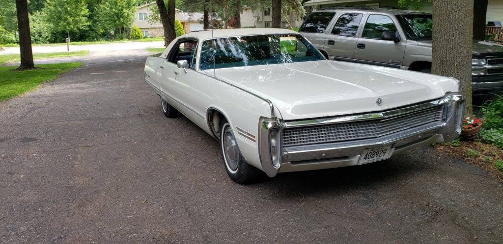

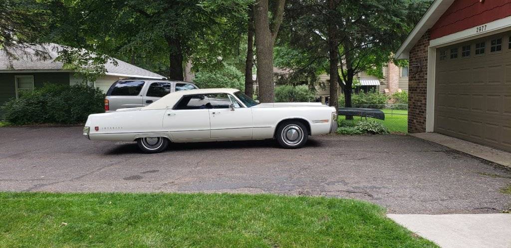

Took Lee over to the VRBO across the lake from our cabin. Family in town and more coming in waves for a week of Minnesota lake fun in Northern Paradise.

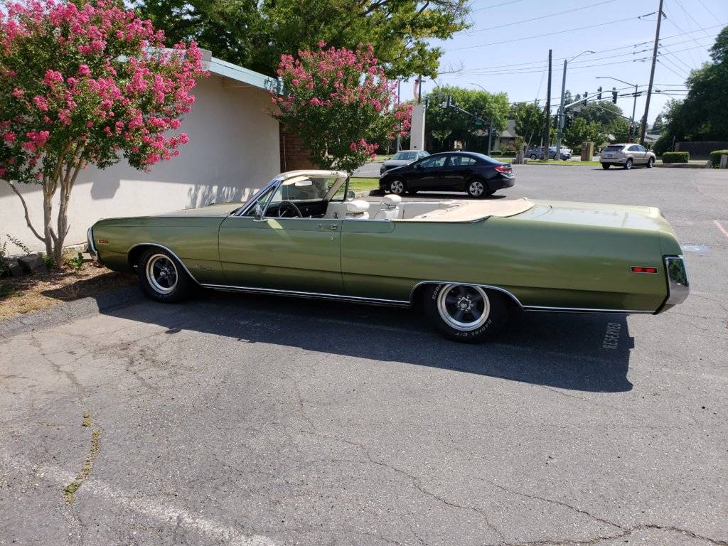

Drove it to my Office, as I have done the past week. Weather has been great!
If you look under the rear of my car, you will see how important I am!! :D

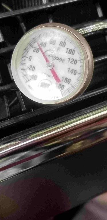

Blowing snow. . . Man! You ain't kidding. That is one cold knee-knocker you got there.

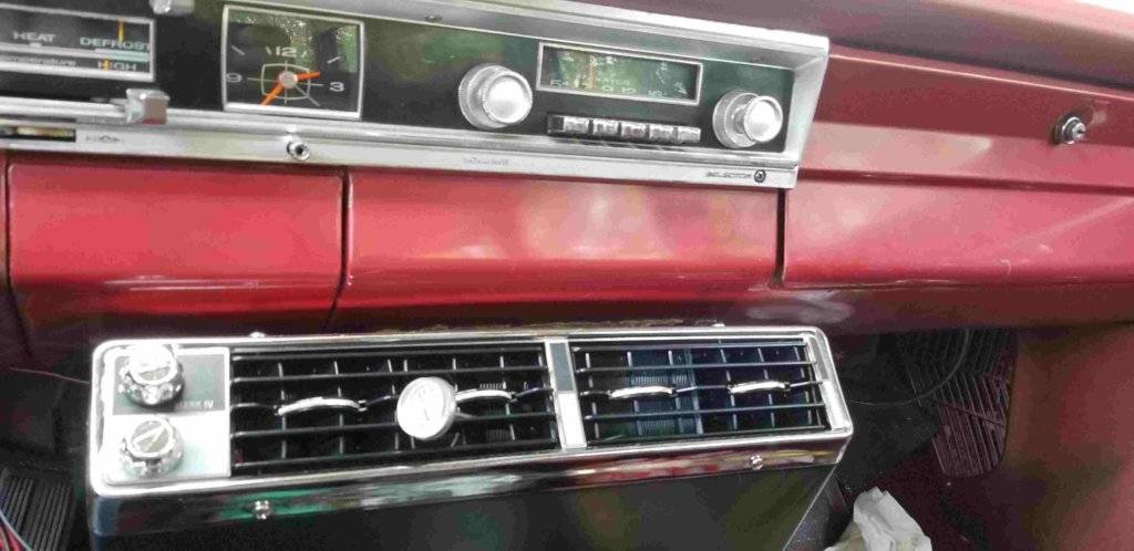

Freon is staying inside too! If anyone is contemplating any kind of A/C plumbing upgrades or new installations, Aeroquip EZ Clip is the ONLY hose system you want. It's more money than the crimp fittings but the only specialized tool you need is the plier to click the clamps shut. Squeeze, click, done, 2 clamps per end. The barb end of the fitting is on 2 o'rings to seal in the hose so if you messed up the clocking on an angle fitting, you can still twist the fitting in the hose after it's clamped.
Also the OD of the hose is much smaller than the conventional stuff so it can make tighter turns in tight spaces.
The condensation however is another thing. Leaking out of the corner of the unit. I had to mount it on an angle because the heater box is in the way of mounting it level and it still being under the dash. The drains of course are back from the corner and flat on the bottom. I'll just have to deal with it for now, no time to yank it out to fix it right.

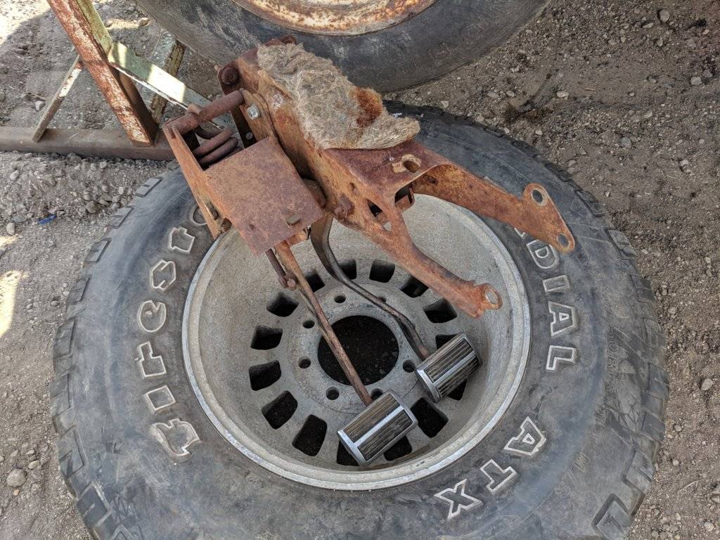

Yesterday I helped kill an oddball, the '69 Newport sedan, 383 2bbl 3 on the tree.
Got the pedals, Z bar, bracket and linkage between pedal and Z bar, for a future project down the road. I was taking it apart the correct way, and having a slow go at getting the pedals out, until I remembered this car is already dead, and I went "derby" mode and prayed away! I felt bad, but no one would be using the parts I bent or crushed. The car is Swiss cheese, and it's way beyond any hope.

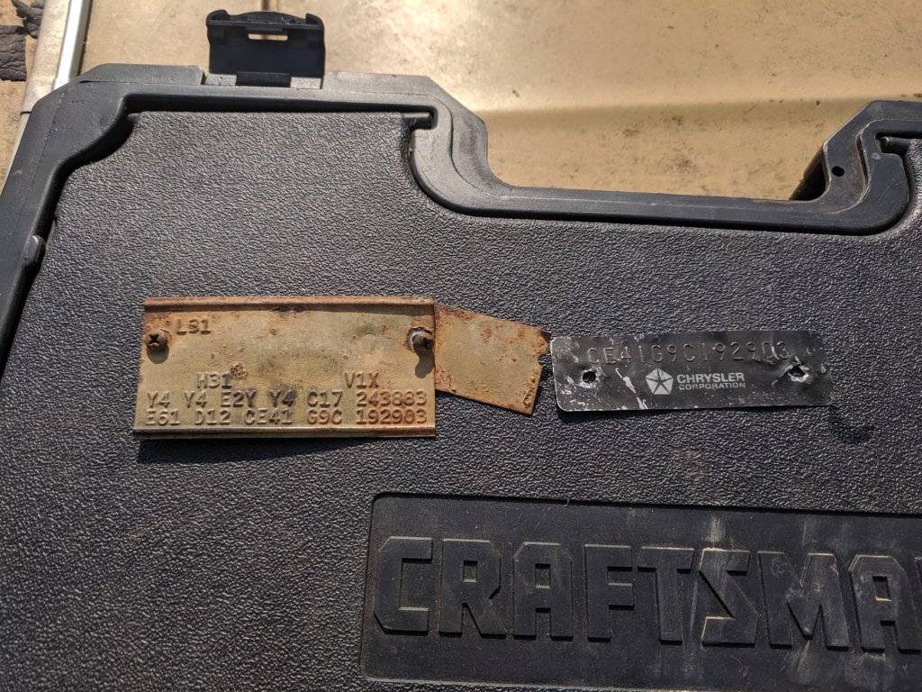

Even got the tags off it for @69CoronetRT for his files.
