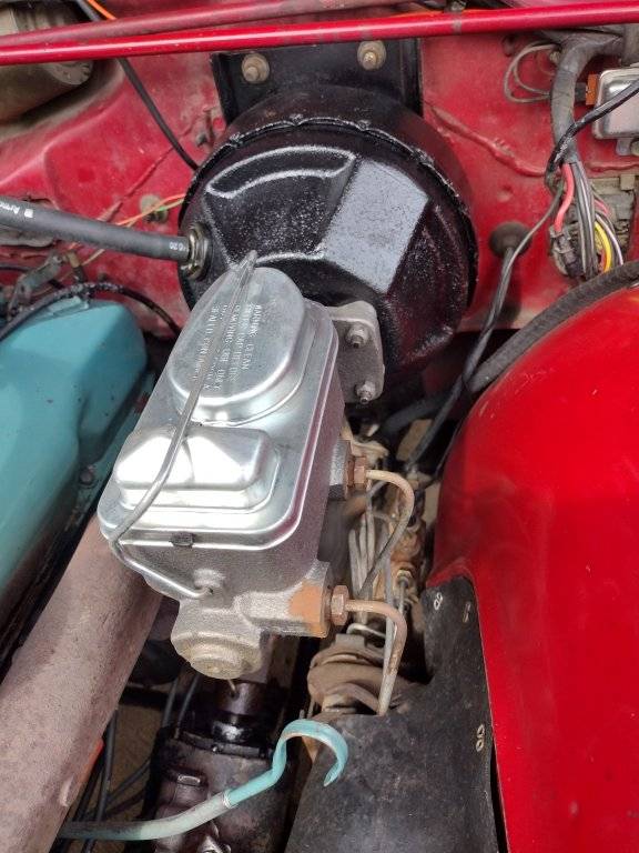

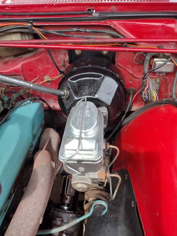

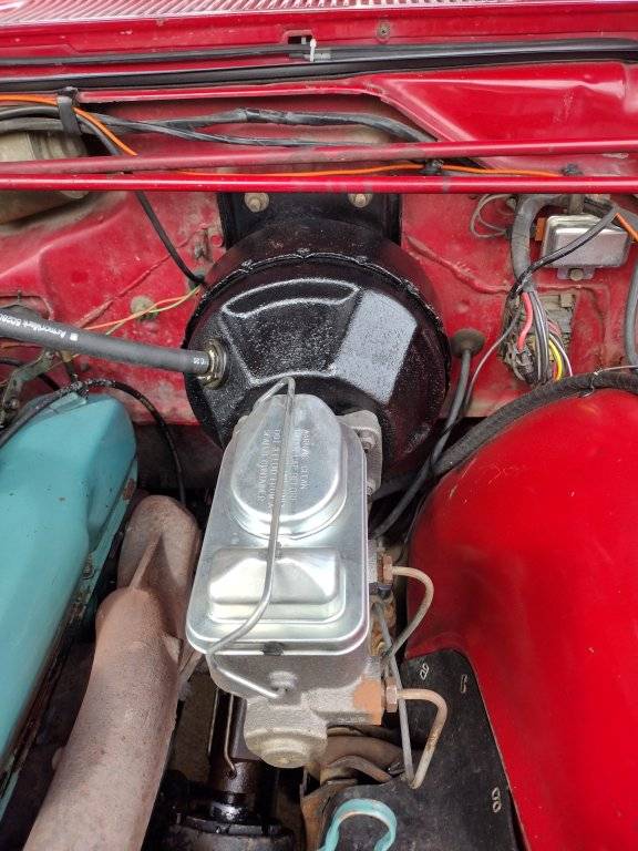

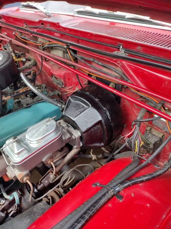

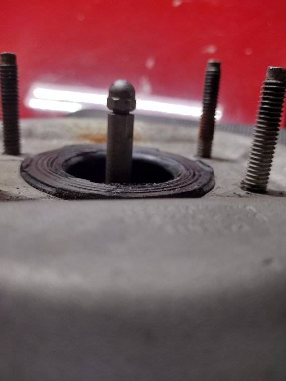

Well after 3 years of search was able to find the correct Bendix booster to complete the front disc changeover on the wagon .I sent it to Booster Dewey for a rebuild and had it installed yesterday along with our annual Pa state safety inspection.The pedal goes a little further than before I just got to drive it to get used to it
I do not think the Bendix booster uses that spacer to the master, that may impact your pedal.

Thanks Alan I'll mention it to my old school mechanic and take it back and have him remove it.Do you know if the rod going into the master cylinder should have a acorn nut on the end of it, the Bendix booster did not have one on it but the one that was on my car that we took off did it was the all drum booster.

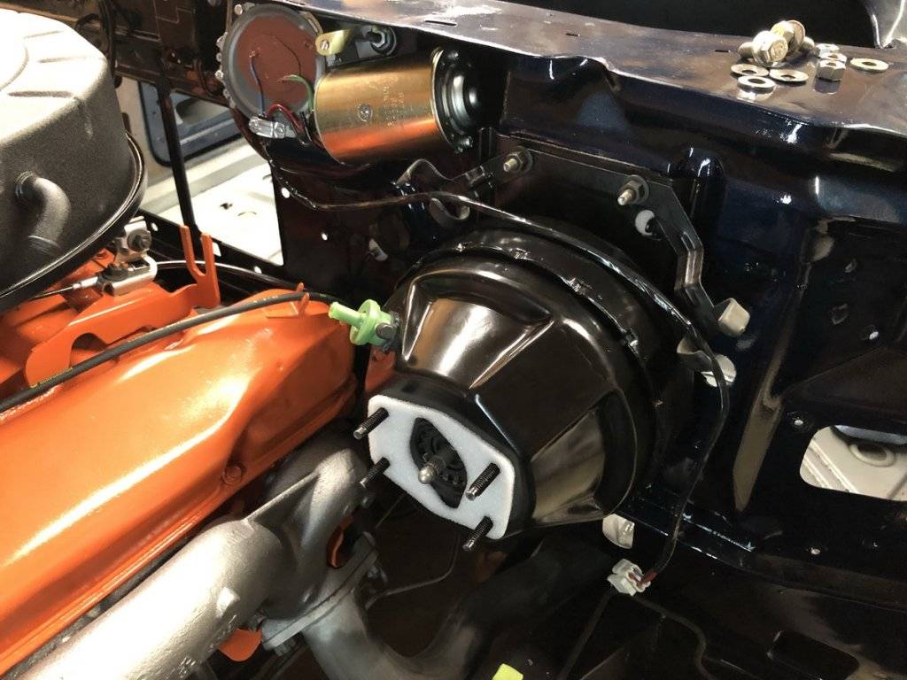

No, just the round nub of the rod

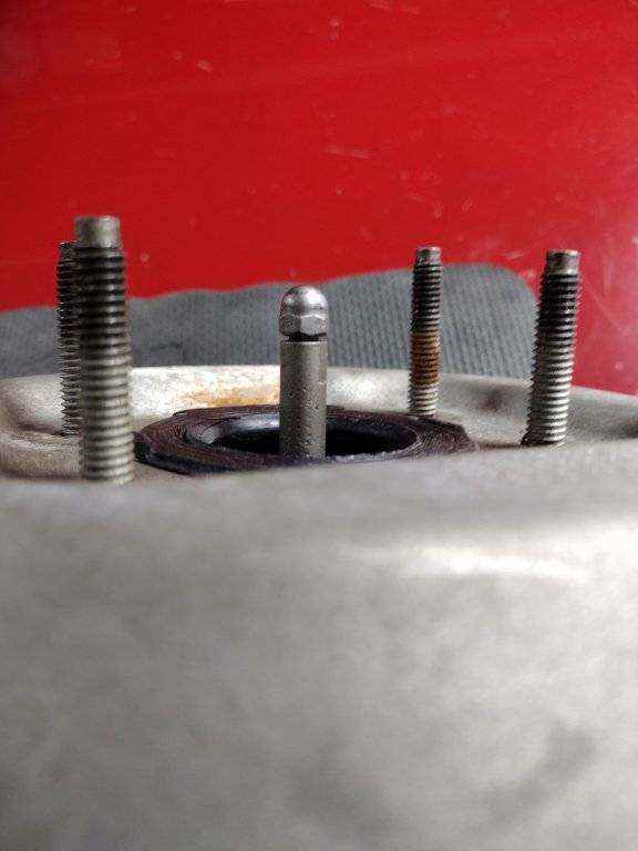

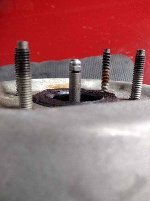

Alan: The booster that Dewey rebuilt for me looks like the one in your picture except there is a stud on the end of the geared portion but no nub that's why I asked if it is a acorn nut that screws on the stud.Here is a picture of the drum booster we took off and the nub looks like acorn nut .

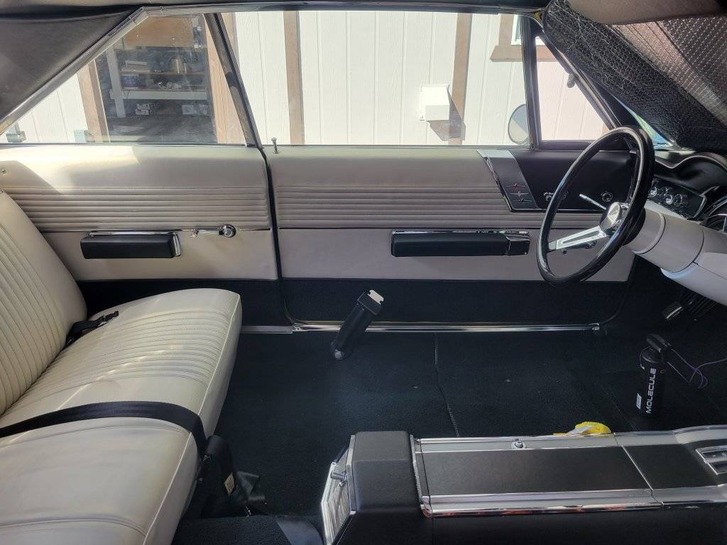

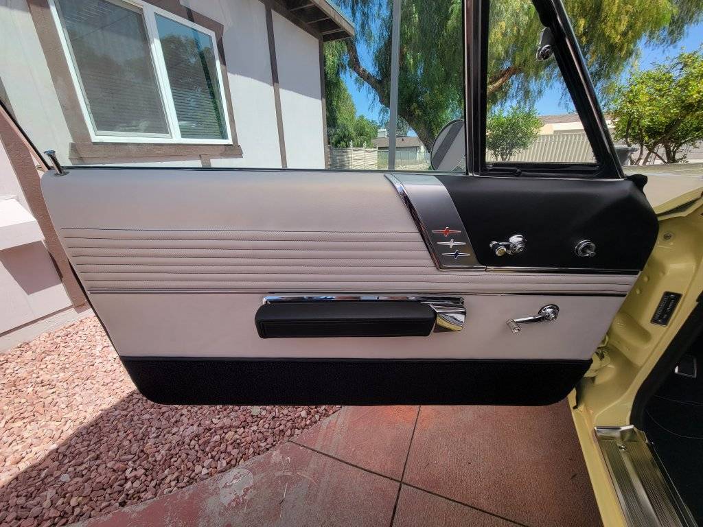

I made some more progress on the interior yesterday. I wired up the vintage air control panel in the console. Installed the kick panel vents I restored and installed the door panels.
