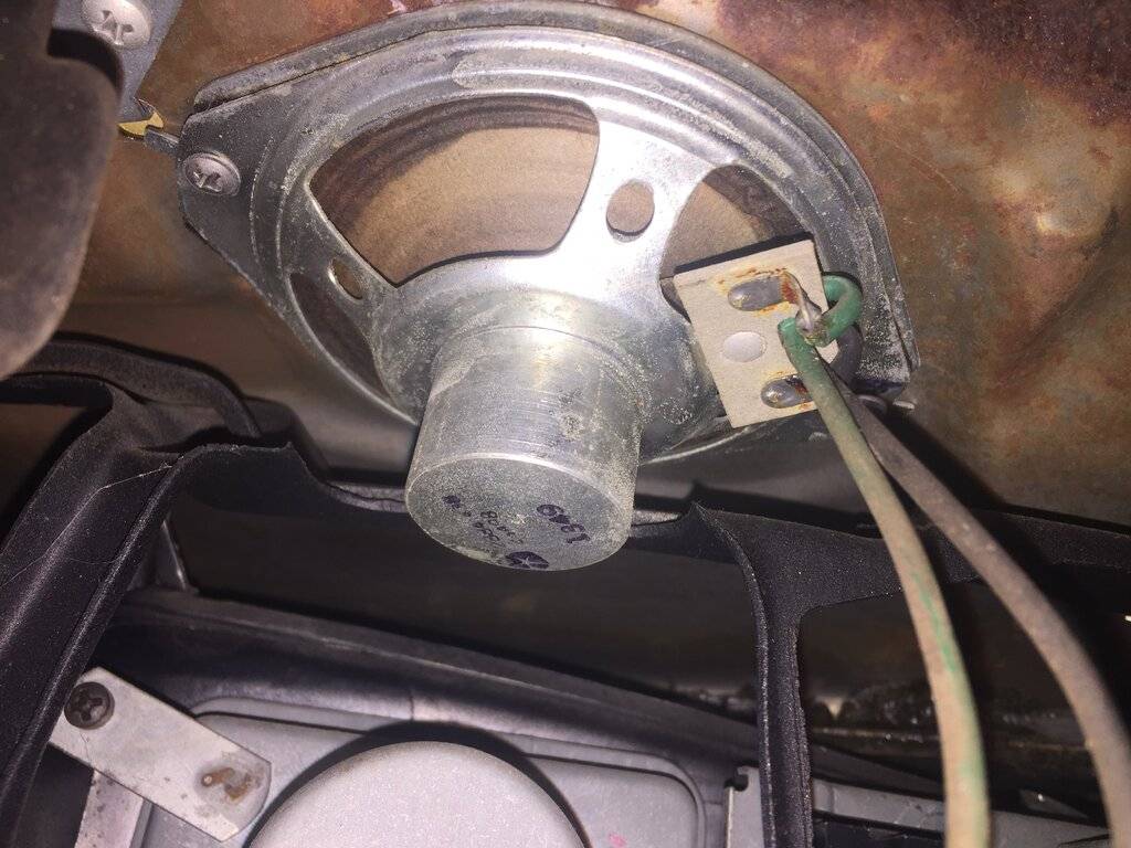

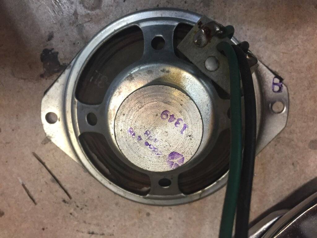

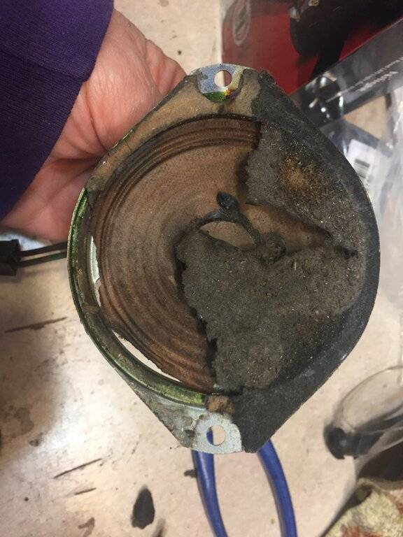

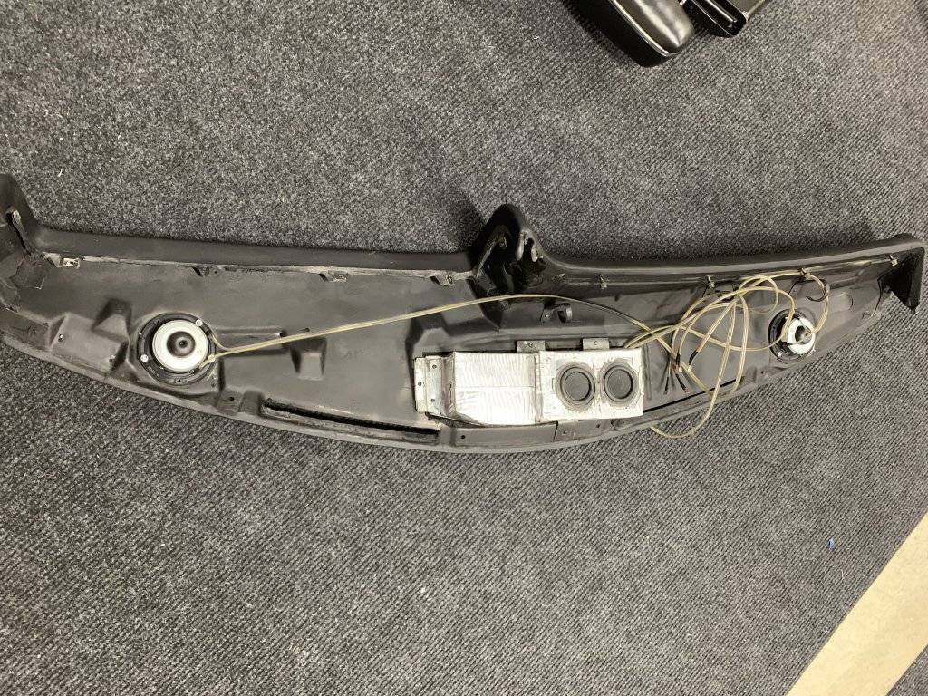

I just happened to have a non-ac 69 Fury dash out and took these pics. I would think these would be called 3.5" round but the actual dimensions are 3 3/8" dia, 1 1/2" depth, mounting holes 4" apart. Looks like the cone has a part number on it. Might be 3505-31. Its hard to read. Maybe -311 A normal magnet 3.5 wont fit without cutting the gauge mount that is in the pic. But that's for Fury so Polara may have different config.
View attachment 431937 View attachment 431938 View attachment 431939 View attachment 431940

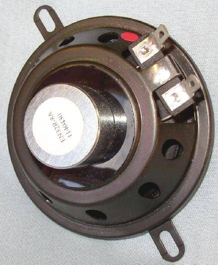

Thank you. What you have matches the specs and the looks of the 3.5" round model at S&M Electro-Tech:
3 1/2" Round - Used in (...) early 70's Mopar front 3 speaker dash locations for stereo radio/tape applications. The mounting ears can be cut off and the speaker held in with the wire clips used on many GM applications(See photo below). We can supply a magnet filler block on request for cars using the Delco wire clip mount.
Note: When used with modern high power radios, this speaker should be connected with 50uf 50volt non-polar coupling capacitors in series to prevent over excursion of the cone at very low frequencies. Some factory GM and all Mopar applications using these speakers have the crossover capacitors installed in a box under the dash. It is even more important when installed with our conversion radios or modern after market radios with high power amplifiers.
Price - $78.95 pair 8 - 10 Ohm Size: 3 3/8" dia. 1 1/2" deep. 3 3/4" to 4 1/4" mounting center.
Looks like a match. You will find small full range 8ohm speakers on home speaker parts sites like Parts Express/Madisound. Those capacitors are otherwise known as bass-blockers. In this case looks like they are blocking <=400 hz. If you want to get stranded wire bass blockers an example is the PAC BB-3PR. If you are looking around remember most of the specs are based off 4ohm speakers which blocks double the frequencies of 8ohm. Said in a more useful way if you want to block <=400hz look for 4 ohm blockers that block <=800hz.

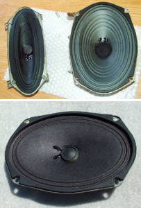

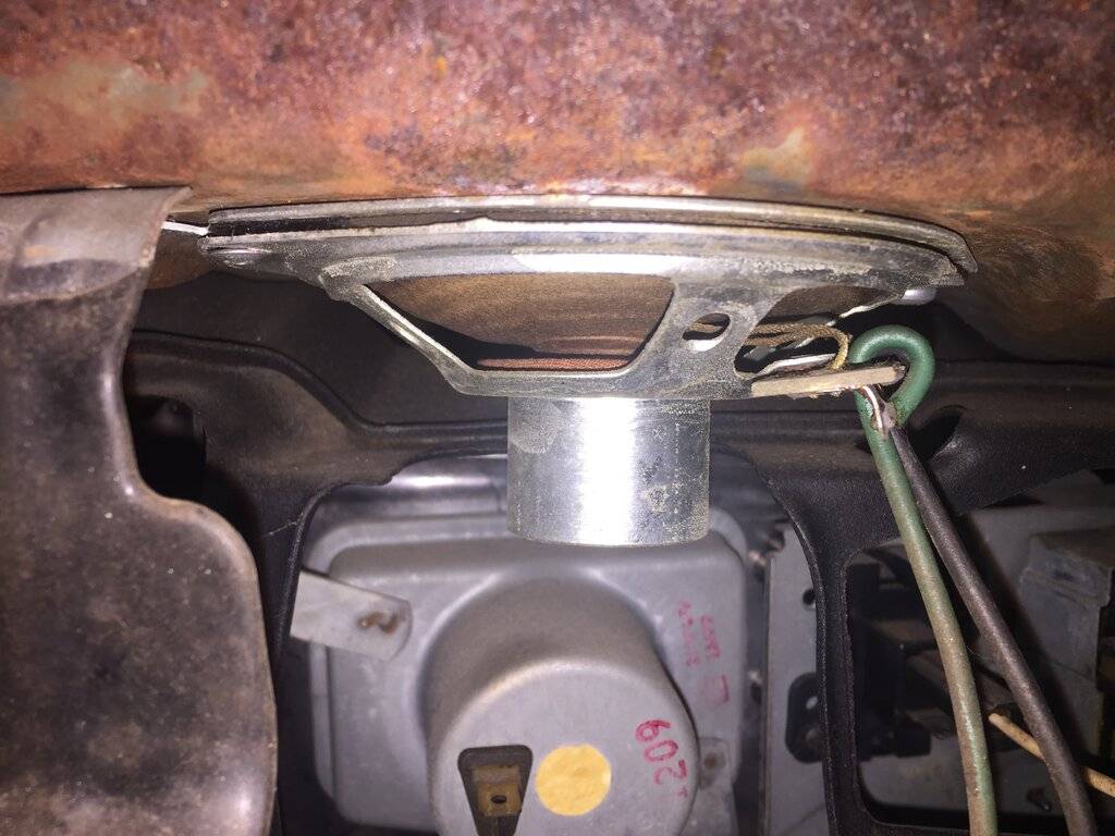

I am planning at this stage to stay close to original but with new/improved components from S&M Electro-Tech, and I have been hesitating between the slimline 4x10 oval and the BIGGER-sized "UNIVERSAL FRAME" 4x10 oval that likely has better sound. I think there is space for the deeper unit but want to be sure as I need one for Regina FQ3 and the same unit for Snow White, her EW1 sister:
Price - $49.95 8 - 10 Ohm Size: 4 1/8"W x 10"L. 1 1/2" deep. 3 1/4" x 6 7/8" mounting centers
Price - $49.95 8 - 10 Ohm Size: 4 1/8"W x 10"L. 2 5/8" deep. 3 1/4" x 6 7/8" mounting centers.
--> One thing that would be great would be if you could confirm the dimensions of the center unit.
Do you want the dimensions of what I built or what the original 4x10 is? Because I sold my only center speaker. I do have another mount plate and I can tell you that is way bigger than 4x10. I fit both of my 4x6's side by side so the the length is about 13" and the width is about 4 1/2". The hole for the speaker is pronably 11". Depth wise probably 4". I can get better measurements for all that if this is what your asking for. Fun stuff!
