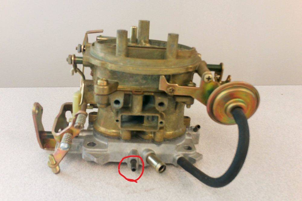

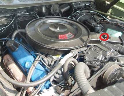

Pointed out in this picture, on my 72 Newport there is a hose missing on the air cleaner. On the bottom of it, there are two hoses that are cut off, one of them goes into the back of the carb (plugged off) and one goes to the red circle in the picture. They connect at a part that sticks up next to the carb. What are these for? Should I reconnect them? The car sometimes is a little slow from a stop, but can still haul *** and is hard to start cold especially if it sits longer than 2 days. I know that means the carb needs some fiddling around with, will this help?
View attachment 154203 These are the two cut off hoses

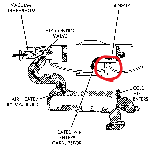

Hello Jon, And welcome to the site from a fellow Indiana resident. The missing vacuum hoses are the control for your heated air intake system. Basically one hose comes from the carb to the sensor, the other runs to the control valve for the door in the air cleaner. Sometimes the valves would leak and most times they were left plugged. Only way to know is buy some hose and hook it back up. Bill

So if the valves leak, what will it change? Will it working make cold starting easier?
If your not going to be running the car in cold weather you really don't need it, it's to provide warm air when the engine is cold.
If the valve leaks you will have a vacuum leak. For better cold starting you will need to check out the choke.
The heated air system was used to compensate for leaner mixtures on startup so that the engine would run better when cold. You can get by just fine without it, it was mostly an EPA driven device that was supposed to help reduce emissions. A lot of them leaked due to the tendency of Mopar big blocks to fart back thru the carb and rupture the valve which caused a vacuum leak and defeated the whole purpose of the things. You can compensate for a dead heated air system by increasing the choke closure slightly.
Dave
You really won't notice any difference if these were connected or not. If these are disconnected and that nipple on the carb is capped, it will run as cars did before they invented this warm air addition. Mine are disconnected as well.

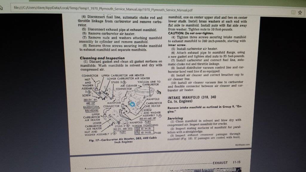

What it does Jon is when the eng. is cold eng. vac is allowed to open the air control valve. This draws in warm air from the exhaust manifold. This prevents carb. icing at the carb base plate. Common failures are the bad air control valve. the sensor and the upper and lower pieces of the exhaust manifold rusting away. Problems it can cause are stalling in temps under 35 degrees when cold. Attached file will give you an idea how it works.

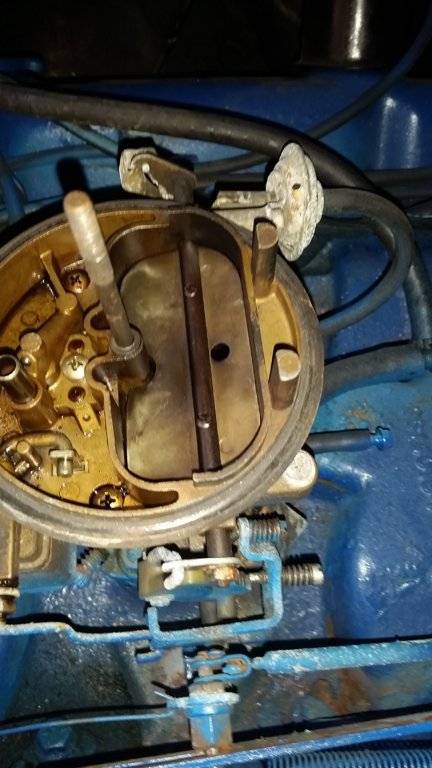

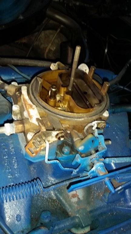

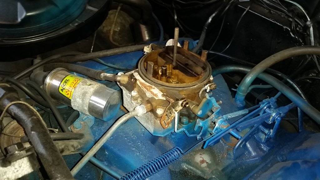

Here is the fully cold carb already pumped for starting. The plate is fully closed. The car sat for 17 years and I dont think the carb was rebuilt anytime recently, Do you think that the float bowl may have a slow leak? It has auful gas mileage.
Definitely for icing. 40° and good humidity level, low rpm, decent pedal pressure is a recipe for icing. That POS Holley is a problem. Fuel evaporating from float bowls is a product of modern gasoline, they no longer add a surface tensioner to it because modern fuel system is not open to the air.
