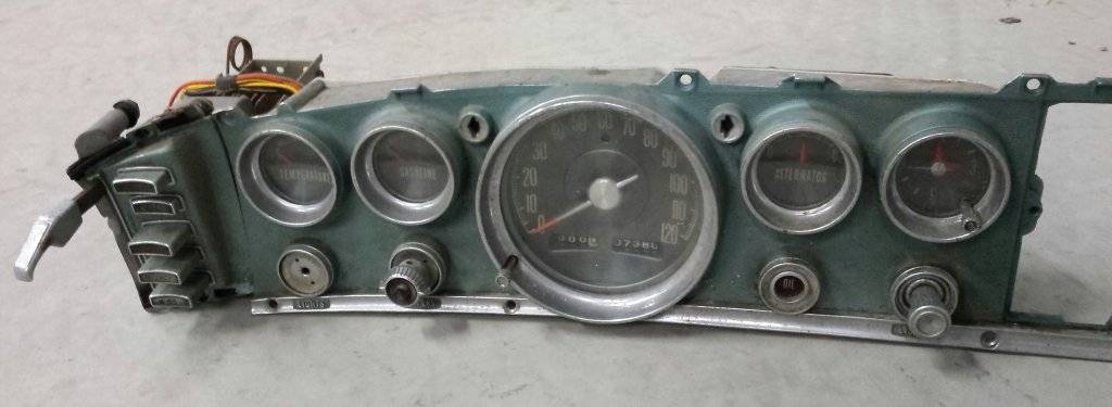

Apr 16, 2016 #1 S sethjof New Member Joined Mar 5, 2015 Messages 31 Reaction score 4 Location Baton Rouge I think that these parts are from a 64 New Yorker. Do they fit other models? Thanks
Apr 16, 2016 #2 Big_John Illegitimi non carborundum FCBO Gold Member Joined May 21, 2013 Messages 24,887 Reaction score 39,731 Location Marcellus, NY That may also fit a 63.
Apr 29, 2016 #3 Snotty Old Man with a Hat FCBO Gold Member Joined Aug 18, 2015 Messages 5,209 Reaction score 4,092 Location Fresno, California Yes, '63-4 all Chryslers with auto transmission not mounted in the console.
May 5, 2016 #4 fury fan Old Man with a Hat Joined Mar 30, 2013 Messages 5,135 Reaction score 4,053 Location Indianapolis FWIW - that 120mph speedo will also fit 63-64 300 and 64 300K. (63 300J uses a 150mph speedo). IIRC, anyway...
