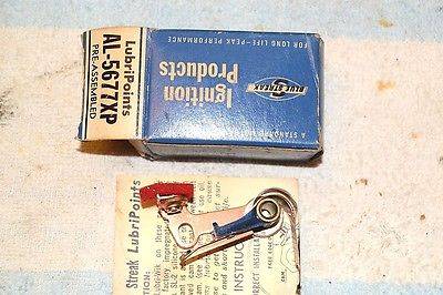

I always use Blue Streak points . I change them twice a year and get them at my local parts shop. Just wondering who makes the correct grease for them if any.
