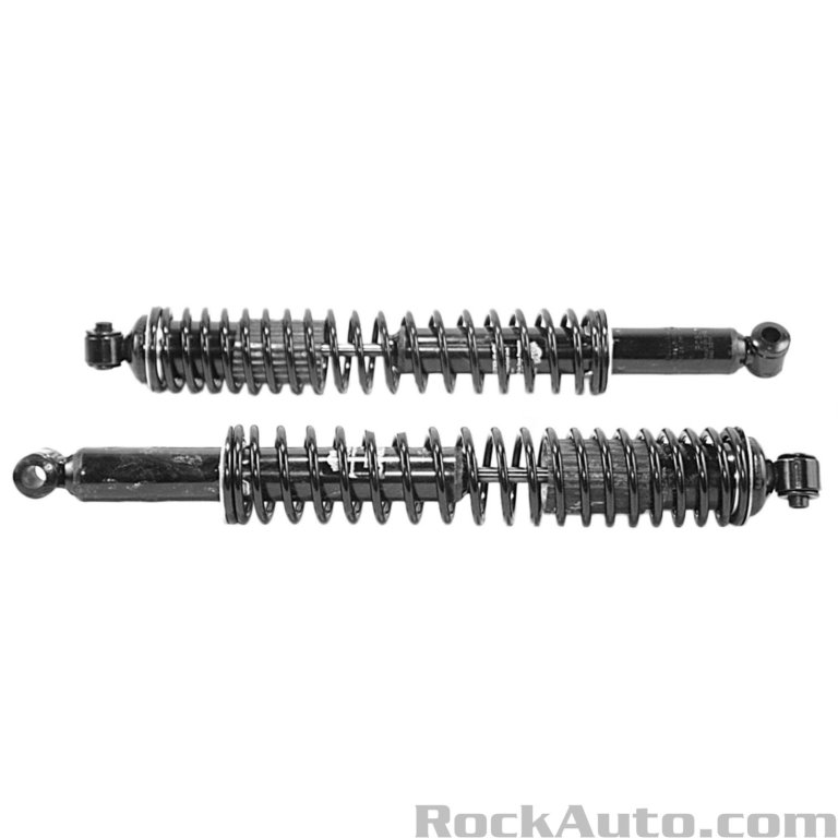

Anyone had any experience with these spring/shock combos??

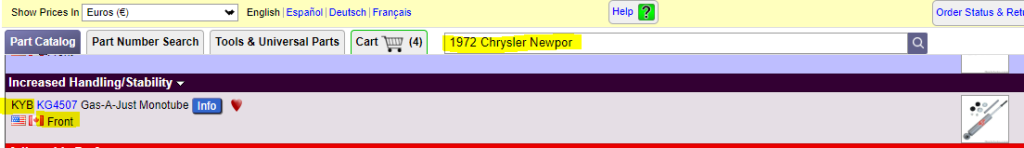

KYB 5512 gas adjust (62 to 78 fury rear) or 343159 excel-g....57-78 fury rear...what car is this for?
Hi Turboomni, I spent hours on KYBs site, Rockauto, Jegs, Summit etc...no one has anything listed for a rear except crappy air shocks from the 80's!!
Thanks man, I found them on Rockauto by searching part numbers not by vehicle make, such a cool site for parts comparisons, I am getting 2 sets now.

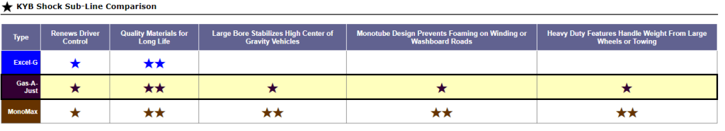

Just an FYI for the Exel-G vs Gas-A-Just models.
Gas-A-Just Monotube
Features:
  • Up to 25% more damping performance over original equipment shocks
  • Triple chrome-plated piston rod and multi-lip oil seals that reduce wear
  • Solid, seamless mounting eye rings and bolt bushings that can't separate and become noisy
  • Chemically bonded insulator mounting bushings that won't slip out
  • A Teflon-coated or phenolic piston band that reduces friction and provides a positive cylinder seal
  • Specially formulated hydraulic fluid with multi-range viscosity for any weather climate
I am going Gas-A-Just front and back from Rockauto, their shipping to Australia is considerably cheaper and faster than other big name shops.

oh and make sure that the check valve on the booster is ok and there are no cracks or vacuum leaks on the hose going to it....if you click on the blue 5512 part number on the rockauto site it will bring up a box that shows all the models that part number fits
Do NOT waste money on the "spring assist" rear shocks. That's what was on my '70 Monaco when I got it. I went straight to Gabriel Hi-Jackers and never looked back. Only needed 60psi to level the sagged rear leaves (at a time when I did not trust any spring shop to redo them). Got better cornering, too! Now, if I wanted to put some N50-15s on the back, THEN I might need more pressure to clear the tires . . . but no need for that. One good thing, to me, is that the air shocks still have the larger pistons of the HD shocks of the 1970s, fwiw.
Now, as to the rear shocks, in RockAuto, sometimes you have to change the model year in the same platform in order to find some things. The shocks from about 1965 to 1973 are generally the same for C-bodies, especially the front. For some reason, the rears on the C-body sedans are not the same as for the C-body wagons, as the wagon shocks also fit B-bodies, for some reason. Been that way for ages.

You probably did not look correctly on Rockauto.
I found the KYB in 1 minute, for the 1972 Chrysler Newport.
