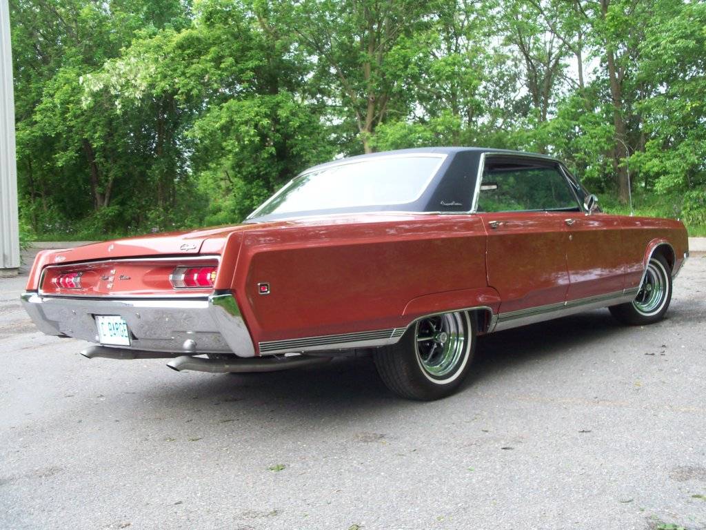

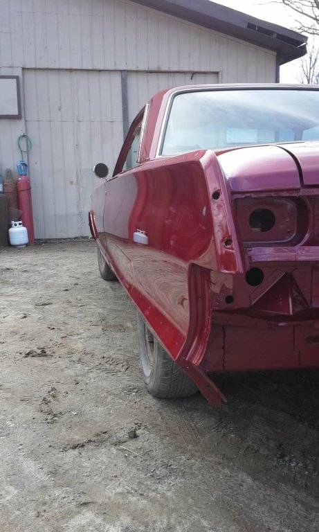

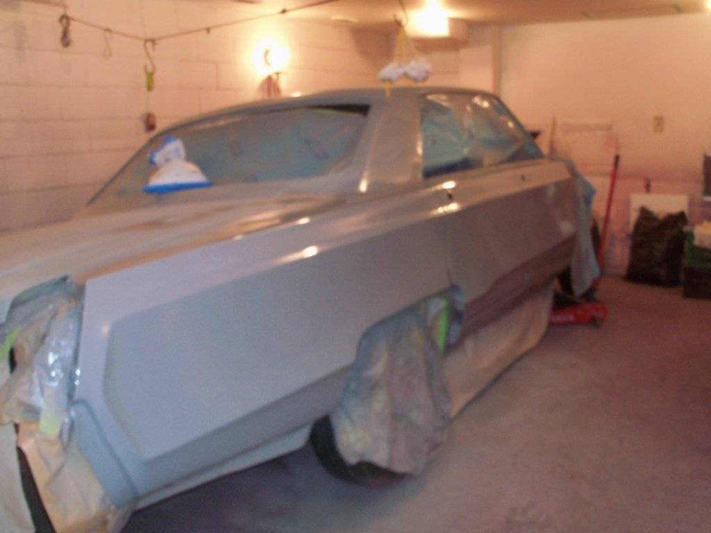

A collision shop would likely use air-powered orbital and straight-line sanders which are maybe 2 feet long. In contrast, Painter Paul block-sanded my car by hand. He made custom sanding blocks for my car which were 4 feet long, so that the bodywork would come out perfectly straight during block sanding. The results speak for themselves:
