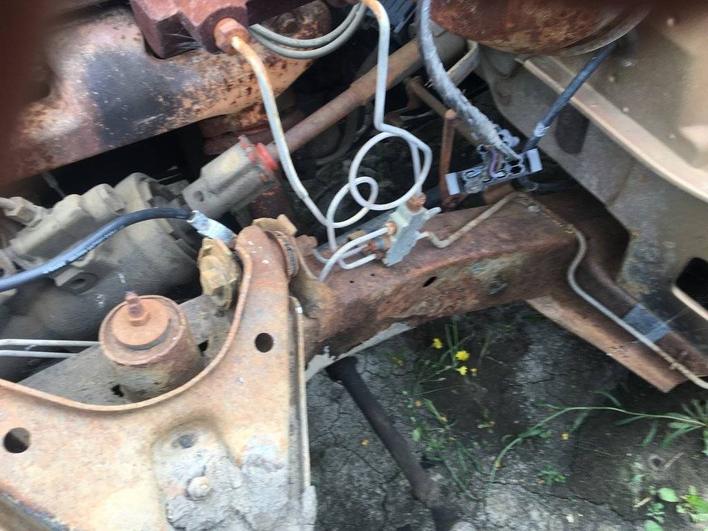

so im in need of help from anyone with a 68 fury or newer that can tell me which ports are which or post a pic of the brake line splitter on your car.
i removed the 68 dual master cylinder and splitter from a good donor drum car to install on my 65,also has drums.
the lines from the splitter to mc are still connected,
but im not sure which lines go to the front and back of splitter.
can someone help me out?
This is a picture of a 69 fury parts car I was taking the stub frame off of yesterday I hope it helps it had power drum brakes
The rear line on M/C goes to front brakes. Front line goes to rear brakes.
The switch/splitter in picture above is split horizontal rear brakes pass through bottom half and fronts through the top half.
Thank you Guys,between the 2 posts thats what i needed.
car has all new brake lines and fittings,and master cylinder.
ps,i actually did try to google a diagram but got lead into every other car except the one i needed,so TyVm for the help.
