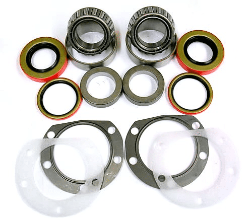

Just looking around the web. This is the kit from Dr Diff. Is this pretty much what I need to do it all? It's a 67 Fury wagon. Looks to be an 8 3/4 rear (I'm pretty sure it's the standard rear for all big wagons of that era). It's wifey's wagon so I really don't need super high performance. With a stock 318 2 barrel she is not hot rodding around town.
IMHO, buy the Timken option to get a better bearings.
I've bought these pieces separately through Rock Auto to save a few bucks, but I'm cheap and had time to pick and choose. A complete kit is a good option.
Unless you have access to a press, you'll still need to have the old ones cut off and new ones pressed on.
Ok, the Timken sounds good. I do have a press so that's not an issue.
