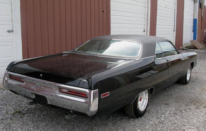

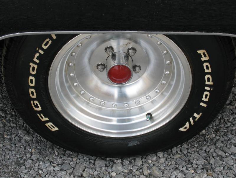

I have 15x8 4" BS on my 66 with 275/60. The tire is a little tight on the skirt but doesn't rub. 4.5" would put the tire in a little deeper and still leave lots of spring clearance.
5" will probably fit but on my slab I would measure/confirm spring clearance first.

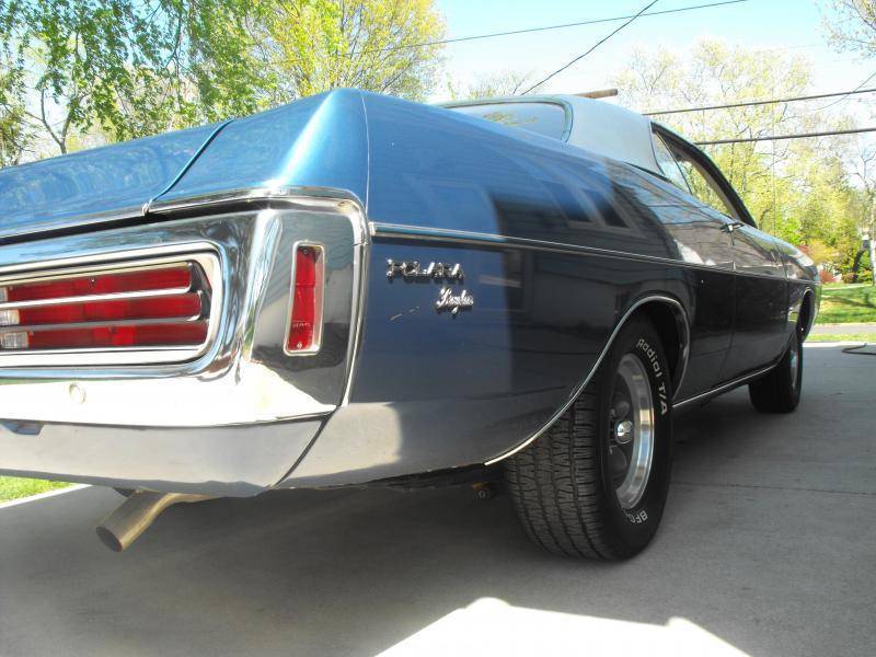

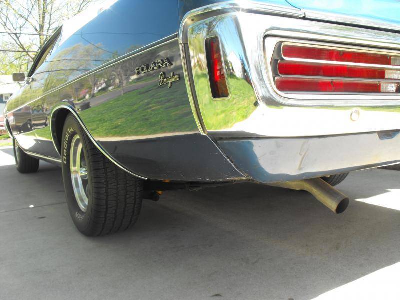

My 71 Polara Brougham, Those are 275's... damn it, I will have to look tomorrow I think 275 60s on 15x 8" wheels with a 4.5 back space. I am certain a 5" will work but never tried it
