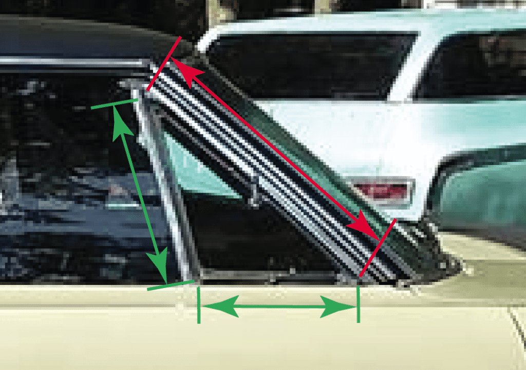

I know that many of you have numerous vehicles. If one of you would be willing to take some measurements of the a wing window I would greatly appreciate it. This is an image I grabbed online.
I'm trying to determine if the gaskets from a B body could be massaged to fit at least the 67 and 68 C bodies. Angles would be wonderful too if someone had the means to measure them.
The B body gaskets are reproduced and much more affordable than the C body ones when you find them.
Thanks for any help.
Sedans and Hardtops are not compatible with each other. That said, I doubt if B and C bodies vents are either but Good luck in your search.
Which ones?

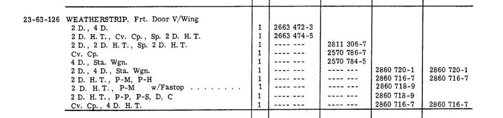

The B body gaskets can be bought for about $110. Currently there is a set for 65-66 C body for $428. If there are C body ones for less point me to them please.
All the C-Body ones, I checked all the numbers listed in the 68 parts book.
Alan
2860716
2860717
2860718
2860719
2860720
2860721
Alan
