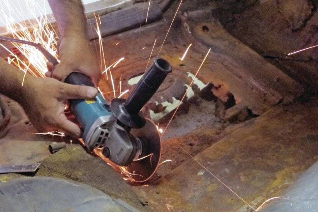

Yea I'd just thought I'd spread the joy of grinding... you know when the grinding wheel goes through and too deep and catches an tears it all up so then you come to the realization that you really need to replace the floor pan with fresh metal.

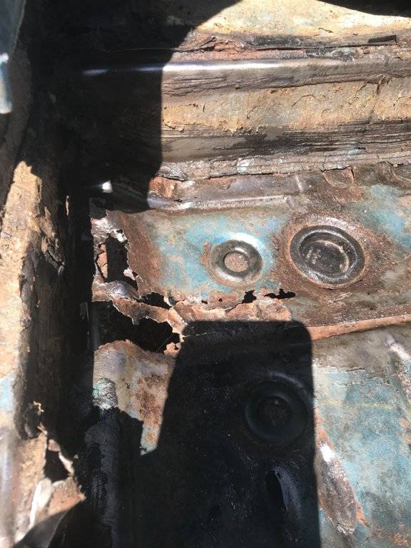

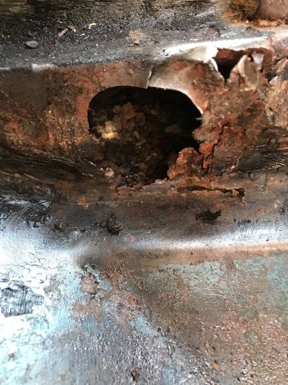

I have a pretty big hole in the floor. About the size of the plastic mat part of the carpet.

Wire wheels on a 4 1/2 grinder are great for finding pits and thin spots. But not for weld or paint prep.

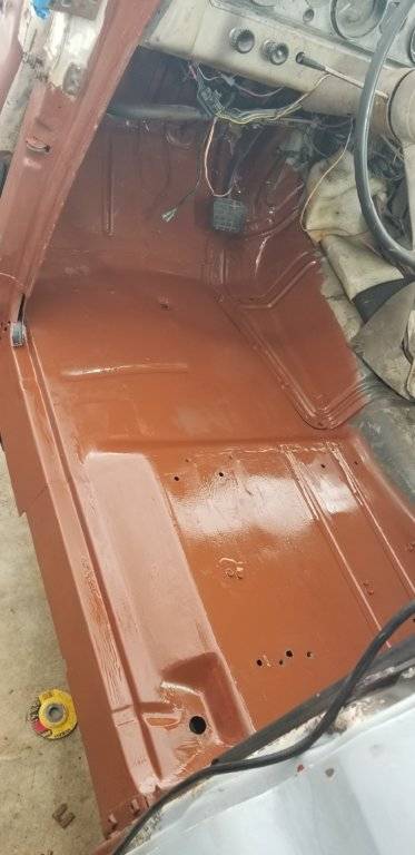

Also I like Rustoleum for floor patching. Red Primer then an enamel top coat. I use small foam rollers and cheap chip brushes from home cheapo.
Low mess and fumes.
I've used that Rustoleum (old school) ah it kind of stunk thou. Worked good, nothing re-bubbled through after many years, but I did good amount of grinding to completely remove all the surface crud. I've used both rattle can & brush on quarts to good results.

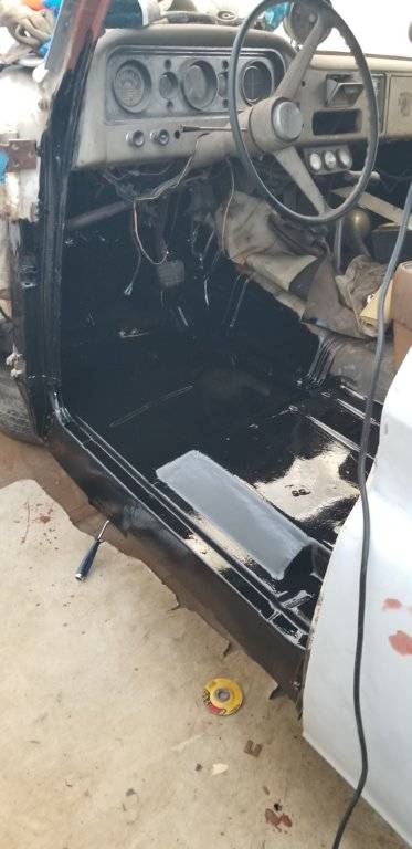

I am debating on buying another floor pan or trying to fill the holes. They aren’t huge. Watched a video where a guy used fiberglass mat and painted POR-15 into it.
Passenger seatbelt (lap) nut pulled out as I was loosening the bolt. That’s a weld job but not sure about the rest.

I suspect that you will replace the floor pan. Whatever you do, it will be the right thing.
