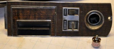

Does anyone know what type of wood this wood grain imitates?
My guess would be some sort of a walnut

I know '67 was the last year for the real wood veneer or, at least that's what I've read on the web and in '67 it is walnut.
Sounds like walnut is the answer. Thanks!
I decided to do a complete exchange of all wood grain because I will never find the exact stock pattern. I'm not sure which way to go. In my final selection are 3M Di-Noc foil and real wood veneer. I will do more research and a few tests on both methods before I choose one.
