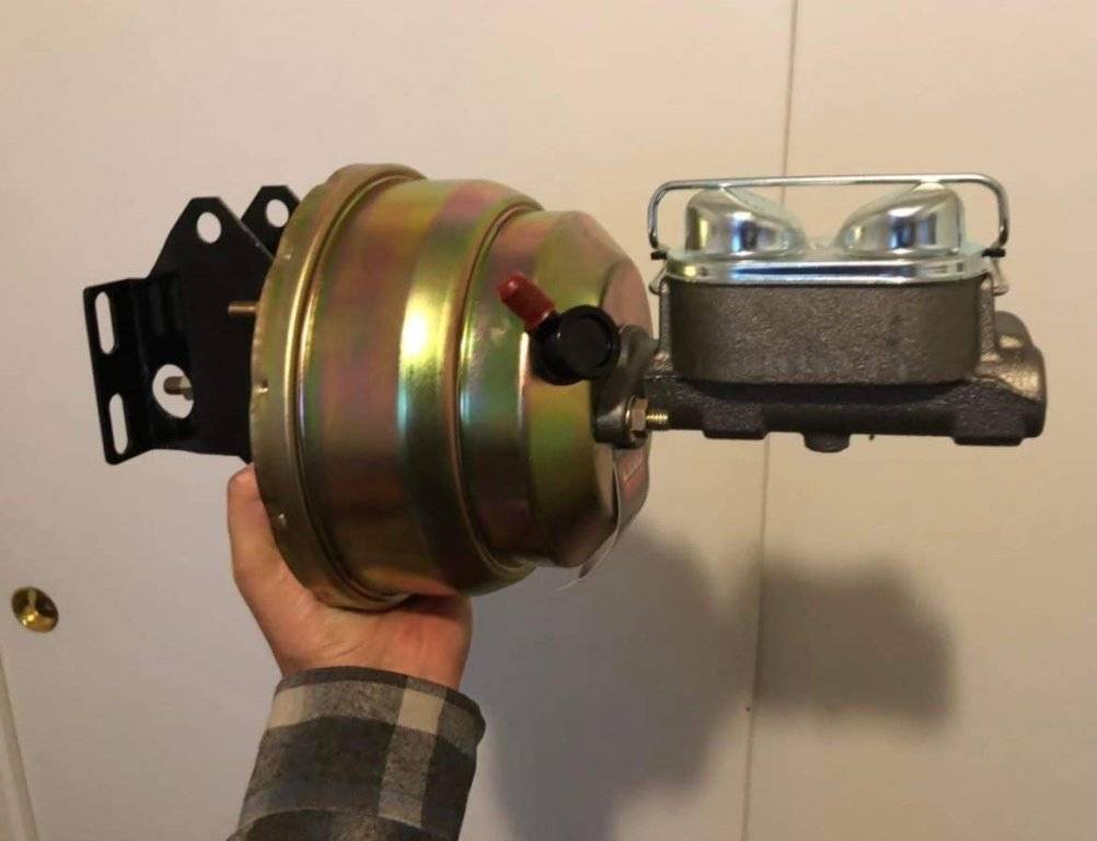

Bad news for starters --- that is a 4 wheel drum brake master cylinder --- notice that they are equal size chambers --- and not a Front Disc / Rear Drum master cylinder.....

Just to confirm, the booster is fine, but get a disc MC? I appreciate the help!
You need to find out the exact application of the booster AND the master cylinder separately. What car, weight, and type of brake system.
If the master cylinder is a power assisted drum brake master cylinder, typically they require less boost than similar disc brake master cylinders, and hence the boosters are of lower strength than a disc system booster. This is why Chrysler has two different boosters for the two different brake systems.
If that booster and master was for a drum brake system I would expect that you need to swap them out for ones from a disc brake system. If the booster is a proper disc brake booster for a full size car, and just the wrong master has been both to it then all you need to do is get the proper disc brake master cylinder. Based on what you told me on messenger I still have more questions and concerns so if you like let's continue that conversation over there.

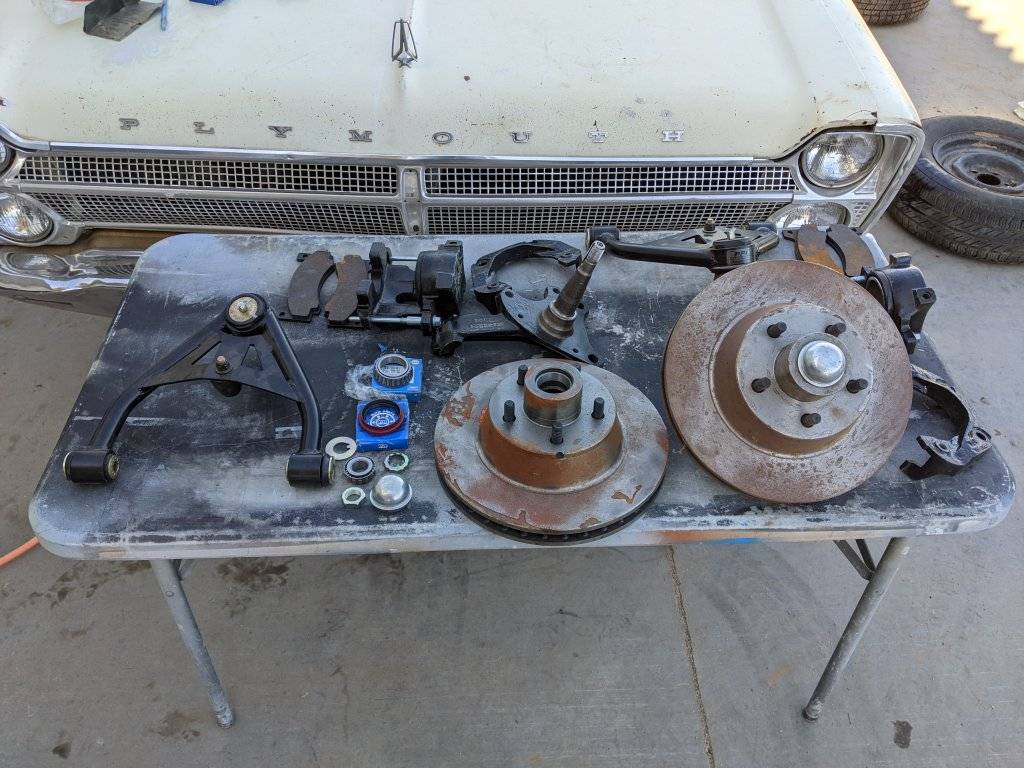

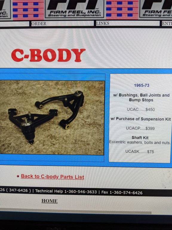

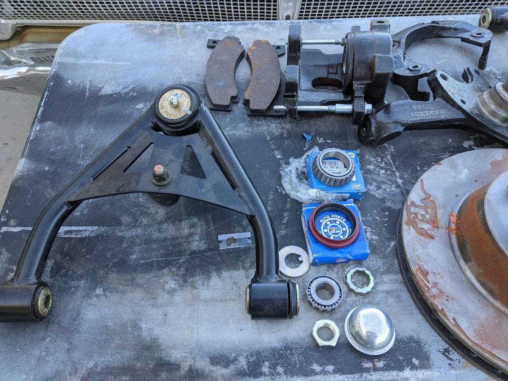

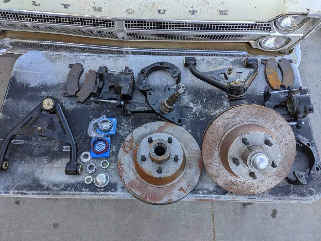

If you're interested I have a set of 69-72 disc brakes. Comes with new rotors, bearings, pads, rebuilt calipers and new Firm Feel tubular upper control arms with new bushings and upper ball joints. Only thing I don't have are the dust shields.
I'm seriously doubting that booster will work for your application for fitment reasons alone. The stock drum brake system can work quite well in these cars if set up properly, you might want to consider that.

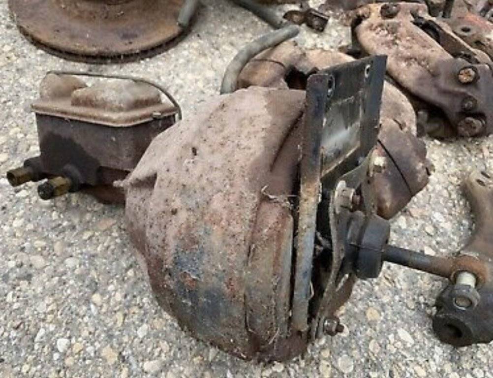

Just scored a 67 Chrysler New Yorker disc brake booster!
Gonna have it sent straight to booster Dewey. Now I need all the other parts. Please get at me with anything you got!
