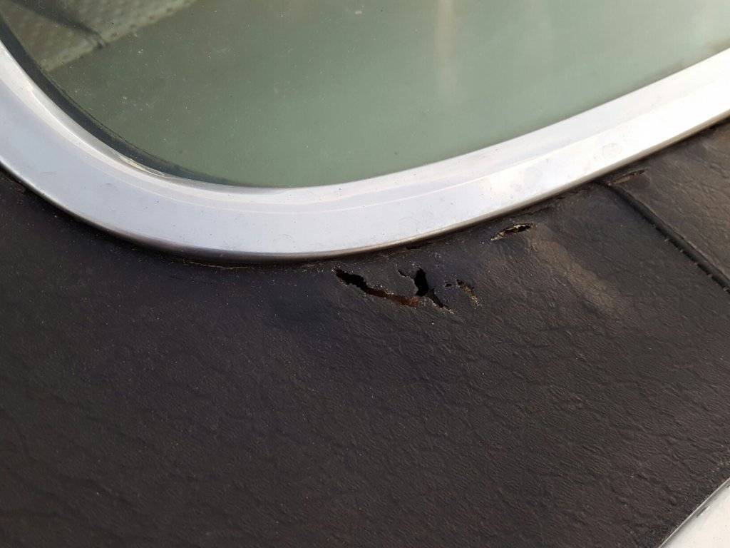

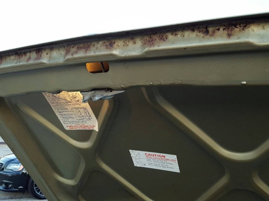

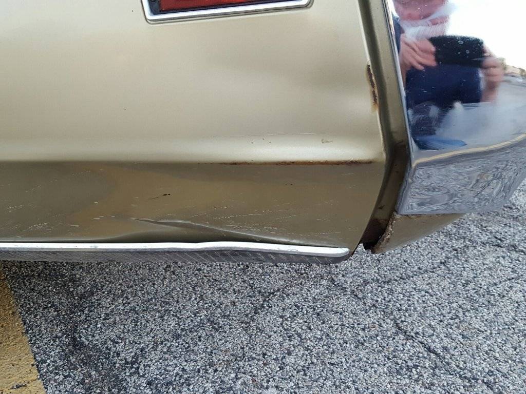

As for the rust I noted, the rear valance had some, and there was a visible rust hole at the rear window where the vinyl meets the rear trim at the Dutchman's panel. I didn't think it was too far gone from what was visible but the top may be hiding more. There was also some minor rust at the rear of the front drivers side lower front fender.

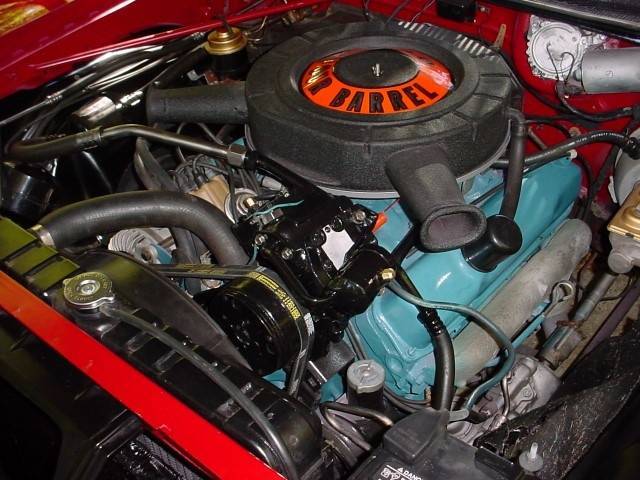

The base 440 did not use a "pie pan", but a sticker. They are available, Osborn offers them.
Disregard the dual snorkel. I had one and took the liberty to have it black wrinkle powder coated and used it because of the high "coolness" level.

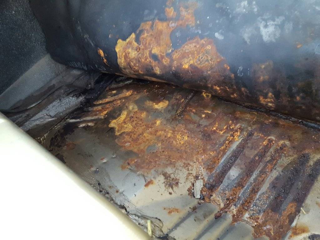

Wtih that hole at the back window, and a vinyl mat, this is the good part of the trunk floor. What's it look like further forward???
My 70 300 had no big holes like this one, or the blue 70 300 we discussed recently, however there had been enough water seepage to thin-out some of the package tray support pieces, and there was a tiny rusthole working into the trunkjamb area.

I regret I didn't pull that trunk mat out, but I'm sure the rust in the trunk is coming from the small rust hole in the roof
