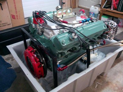

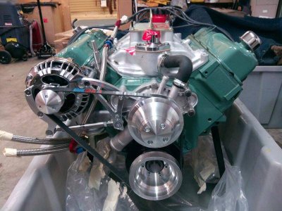

This is the poly going into my fury however its a 360 now. The wide block is a bit of a misnomer because the block is virtually the same size as the LA 318. However notice how the poly heads come off straight which gives it the wider appearance. The LA heads turn upward. I dont think you will find a more solid engine. You can buy the 4 bbl manifold from Weiand.

That's a good looking engine right there, like jewelry.
Great looking poly. I have always liked the massive look of these engines..
I'm not aware of a 4bbl intake being currently offered by Weiand. A long time ago the offered one that was just marginally better then an OEM manifold, but they have been out of production for some time and as hard, or harder to locate as a OEM manifold.
