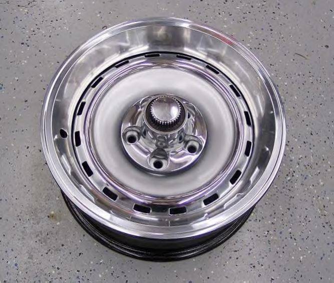

Anybody know of anyone fabbing wider road wheels? Looking for 15x8. I have a set I want to convert - if its even possible.

Aidan on here did have a set converted to 8in, this is the website for you, hope it helps.
http://themopardude.com/New_Custom_2.html
they turned out good to your recollection?
I would worry a bit about the offset (would it be too "positive" -- like more than five inches - reducing inside clearance?) guessing the "cutting and pasting" would be strictly on the inside.
this outfit you provided said he removes the centers .. BUT the OEM trim ring wouldn't look right if the outside face was messed with right?
Anyway, I will call and ask what can be done. and if Aidan chips in that'd be great as well.

I didnt get to see the rims personally so I cant comment on what was done , what the offset is etc, Aidan will have to fill you in on all the details.

I am going to proceed on the basis that to get another width of 16-slot road wheels, an otherwise good set has got to be spliced/welded or whatever they do to get what I am looking for.

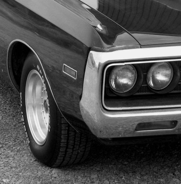

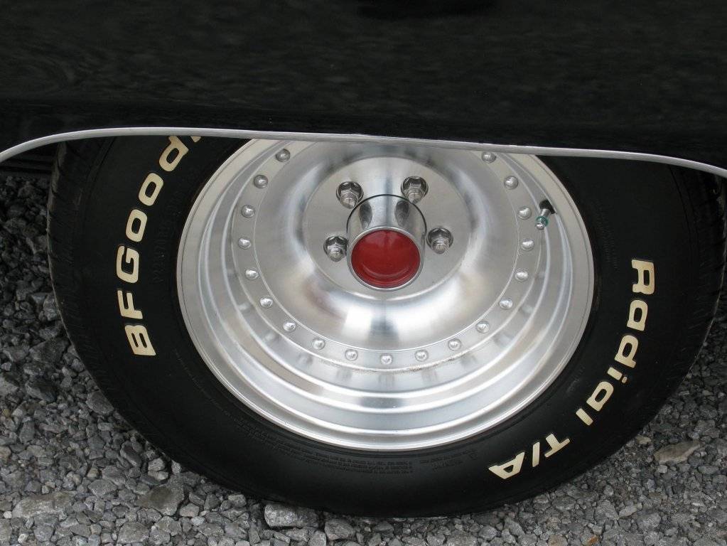

This 15x8 aftermarket wheel fits perfect under the rear wheel opening, clears suspension front and back, etc.. With 4.5 inch backspacing (nine inches total wheel width) on a 235/70 tire I have the "look" I want.
As mentioned the widening of a road wheel will effect the trim ring fitment. PLEASE keep us posted on widening efforts. I've been thinking of doing four myself
