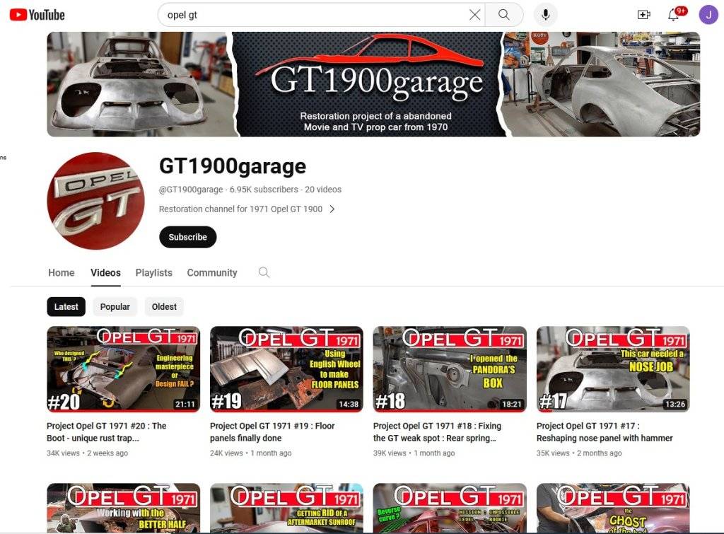

Lately, I've been watching videos of a guy in Finland that's restoring an extremely rusty Opel GT, and he has to make everything himself. He does have access to an English wheel at some other shop for the curved panels, but the rest is done with a bead roller, shrinker-stretcher, and hammer. Bends are done on the edge of a work bench.
Here's a link if you want to check it out:
