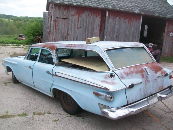

Checked out a '61 Plymouth today and need some info before making a decision. My Mopar knowledge starts at 1962 & up, so a bit out of my norm. It's a semi rough project and is not a 2 door hardtop. I'm not looking to restore the car, but put it back on the road and drive it.
The original Poly engine and auto trans are intact, but the engine is seized up. What "bolt-in" engine options are doable for this car ? Will a LA or a Magnum series engine bolt in ? What would be needed to put a big block in it ? Engine mounts available ? Will a '65 cable shift trans bolt in place and will the '61 shift cables work with a '65 trans ? Any '65-up 8 3/4" axles close in dimensions or bolt in ?

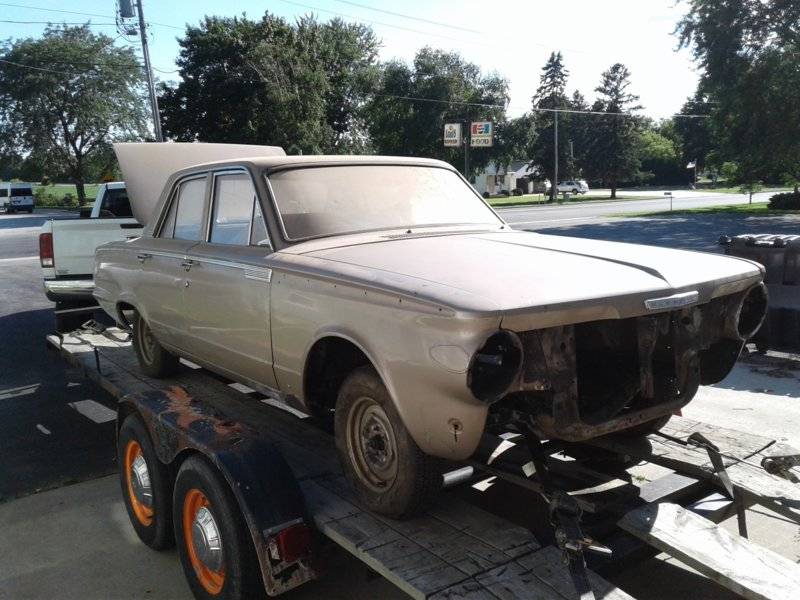

Lots of good info guys and thank you very much. I did find a "filler" car and it wasn't the '61. I decided against it because of other issues...no title, no rear side glass, etc. I did buy a '65 Valiant that should be a quick & easy project to get on the road.
Oh yeah....Muuuch easier! I just traded a running 2 door post V200 for partial on a body shop bill towards a 62 T bird. We had a 64 growing up, and these little cars are great. The 64s & 65s are my favorite Valiants. You still get a ball and trunion joint with these though, I think.
