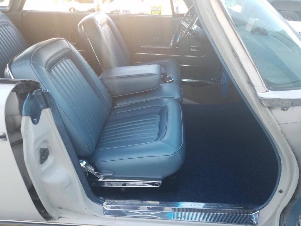

    I took these seats out of a 64 New Yorker . I also took the inside seat reinforcements and they fit my 64 880 floor pan with no problem , if that helps at all? 20180113_151249.jpg 20180329_173402.jpg
    • Like Like x 1
