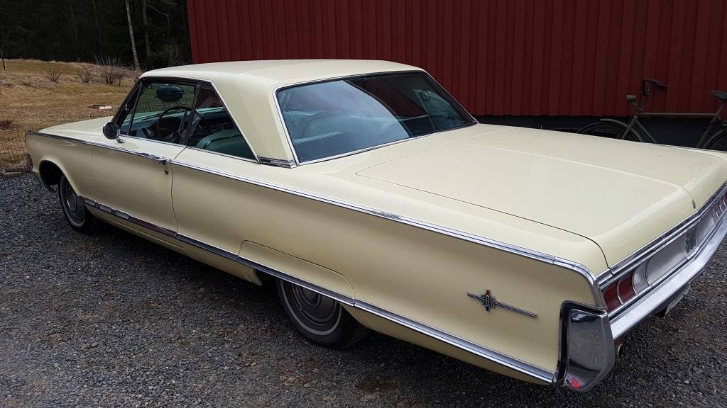

A couple of pics.

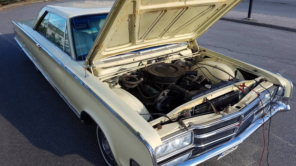

Next in line of things needed attention has something to do with this picture:
A cheap and old battery needed some help and hence it was changed to a new one.

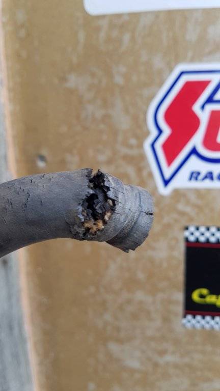

Well then when I was topping up on brake fluid I sort of noticed this barely visible flaw in the vacuum line to the booster, you can see it if you look real close:
So changed that. Good to go.

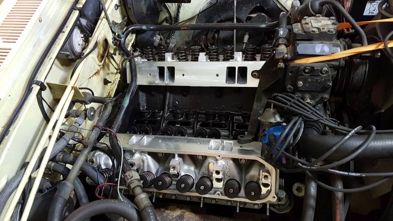

Then I just drove it around and I must say I like the feel of it. Then came the local summer cruise event and it went well until late at night when starting it at home it sounded like something old you would expect being found working at a farm plowing...Did some basic service, cap, rotor, points, capacitor, cables, plugs. Did not help.
Checked the compression, showed this at one cylinder:

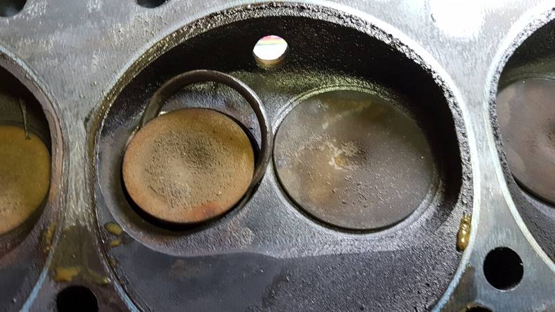

So pulled the head and I think I might have located the problem:
Well, I figured that is a sign for a pair of e-street heads to be ordered, so I did and on they went:
Seems to work and play along nice with the stock 383 and stock intake, cam and carb. There's probably room for a bigger cam with these heads but that will be left as a possible upgrade for the future.

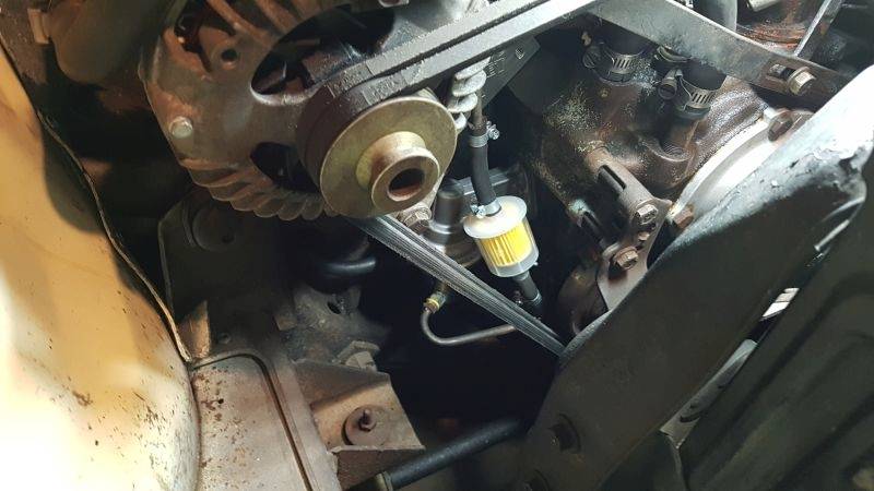

The latest thing being changed is the fuel pump and filter, due to that one day the carb did not receive any fuel:
Which after some help from you guys on how to fill the bowls on the carb through the vents seems to have worked as well.
