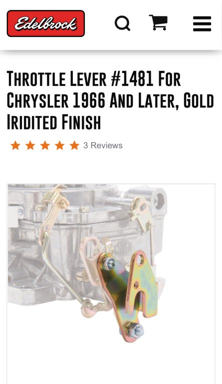

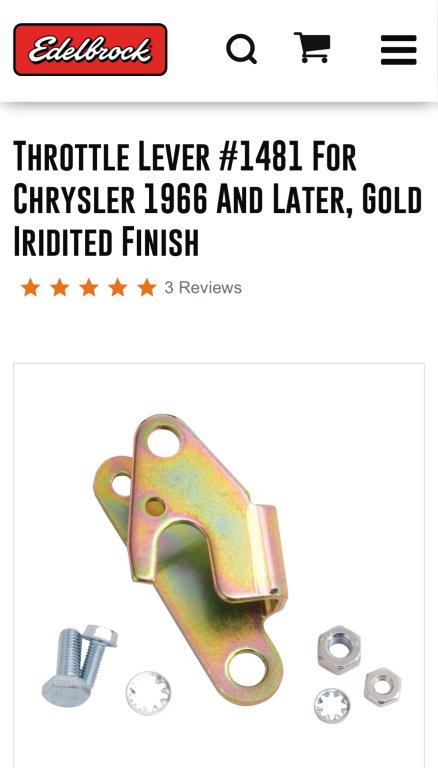

I had spoken with someone from Edelbrock a while back and was told I needed the full Lokar throttle linkage and kickdown cable conversion kit.
If this isn't accurate, I would love to save the $250 that costs.
Also, what Edelbrock linkage adapter? They have a couple different ones.
I've used Edelbrock carbs on a bunch of different Mopars, and have always used the factory throttle pressure linkage. You may need to tweek it a bit, but you can make it work without too much trouble. Get the electric choke version. You won't be sorry. The choke just needs a wire that is hot when the ignition is on. Edelbrock makes an adapter for Mopars so the linkage fits properly. None of this is that hard to do.
Here’s the adaptor you need .
Yes that's the throttle linkage adapter you need, and as someone else mentioned, there is an extention for the transmission kickdown rod. If your original carb was a 2-bbl then the kickdown rod is shorter than the 4-bbl one.
