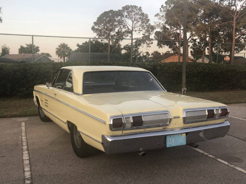

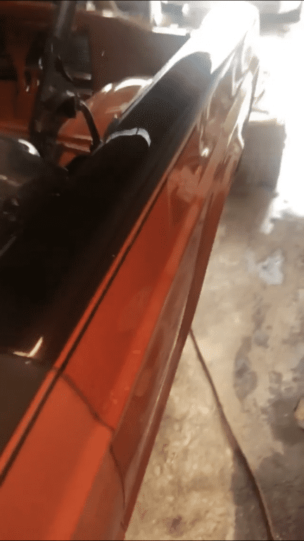

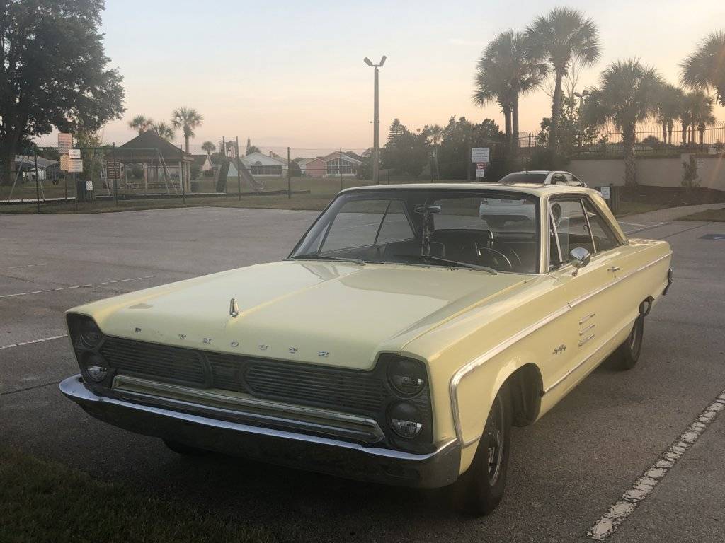

    Heres an update of a little bit of paint. Not a pro but a lot better than before!

    Looks good.

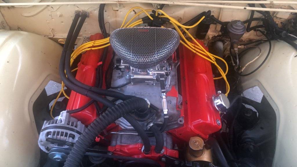

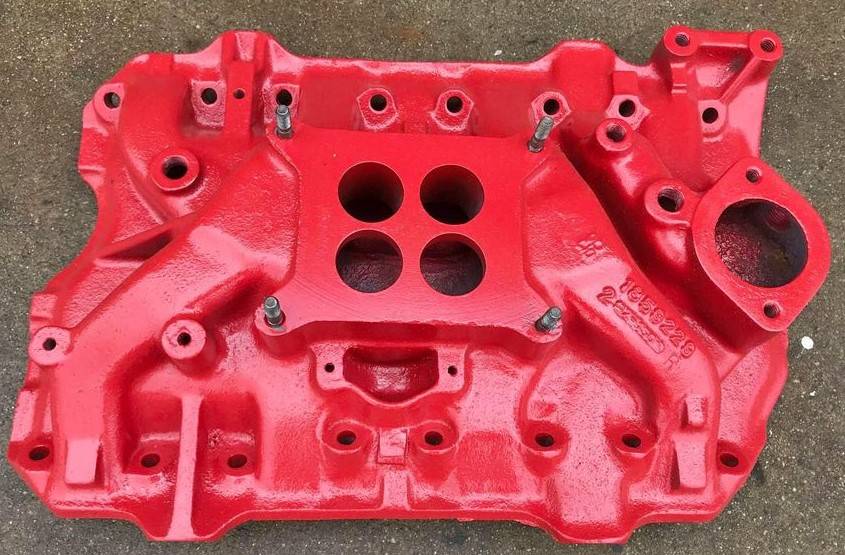

    New carb who is thissss

    Looks great! Keep posting pics of the progress.

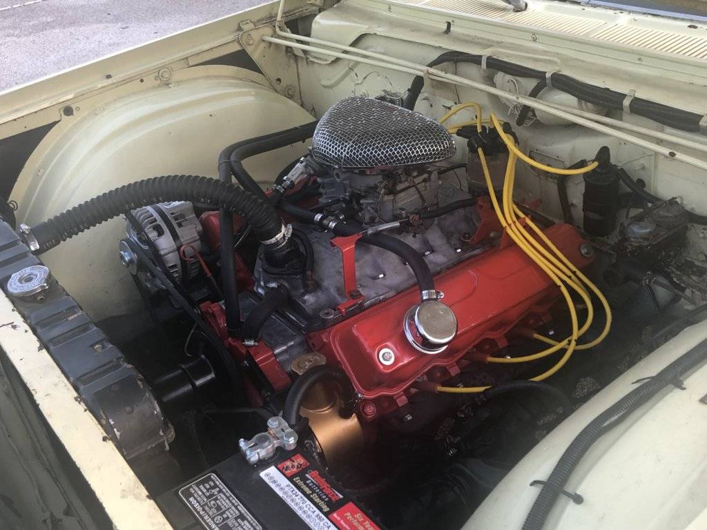

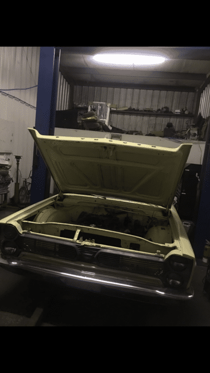

    Nice looking car
    Great looking car. Love the colour it suits the car. Just noticed that I don’t see the transmission kick down linkage in the picture. Maybe it is there and I just can’t see it. If not you need to put one on ASAP or your tranny will burn up.

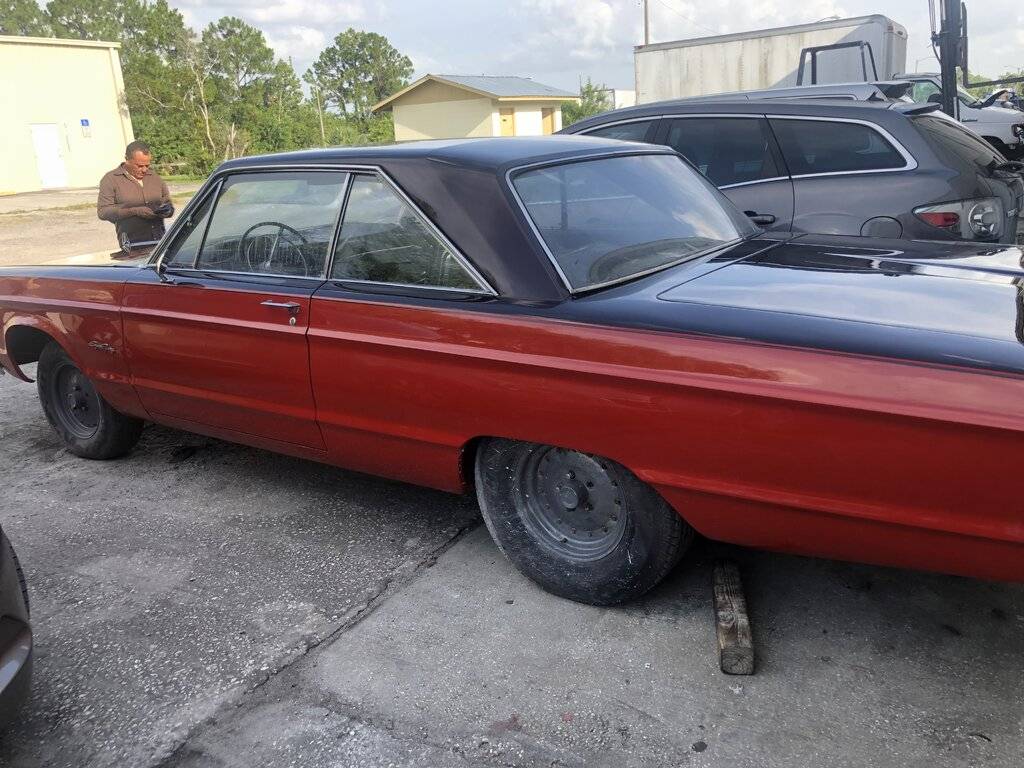

    Off to body and paint!

    I agree.......... Don't drive it without that kick down linkage in place. Also, what happened to the dual master cylinder? I know the single was stock for 66 but I would have stuck with the upgrade.

    I have to agree... for the cost of a new dual MC and doing the conversion, which is easy... you're better off. If you want the OEM look, like it's meant to be there.... go with a unit from a '67 Dual Drum MoPar. You can get all the fittings and lines that go from MC to the distribution block from NAPA. Bend the lines yourself with hand bender.
    Don't go cheap on the stuff that will cost you your life. Good luck on the car... she's a looker for sure!
