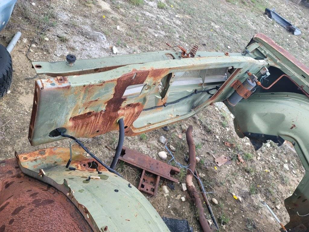

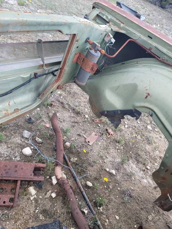

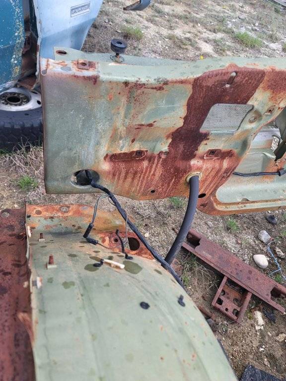

Pics of 26" radiator support.
I am on hold. Attended a car show Saturday and have someone that will look at it and tell me how alternatives or how much to change out radiator and fans. Regarding the pictures. is the top have bends/dents in it or is that just reflection/illusions?
All the 1s I've seen or had looked like that.

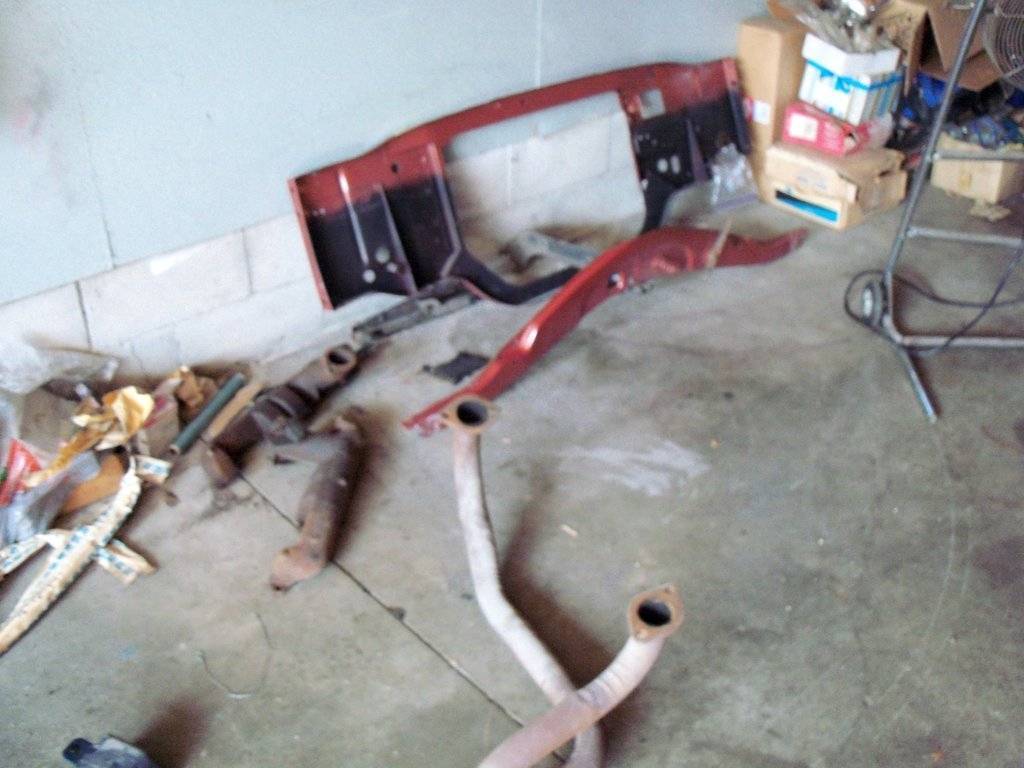

I got my 67 26" rad core support from a Dry Dock member years ago.
It was free but paid shipping from Arizona.
It is not heavy, but oversized for shipping.
It may look twisted but does have some curves to it.
Hope this helps.

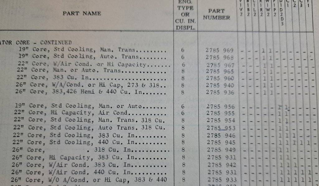

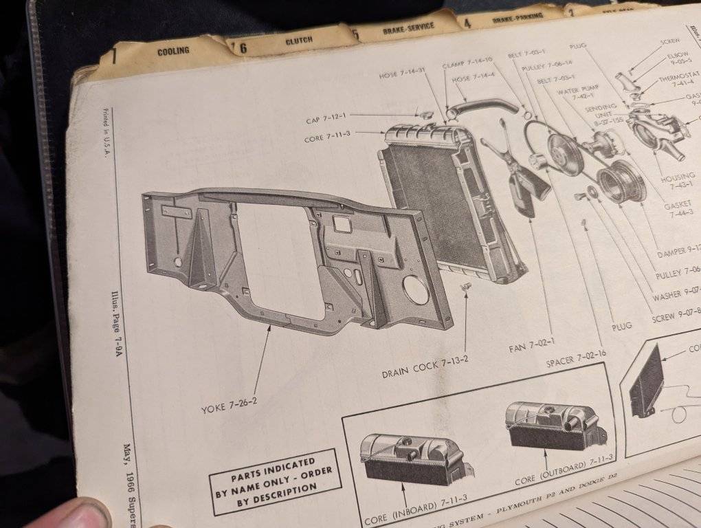

From Ye Olde Parts Book
Any 26" yoke from a '66 ChryCo C body product will work. I have spares I can part with.
