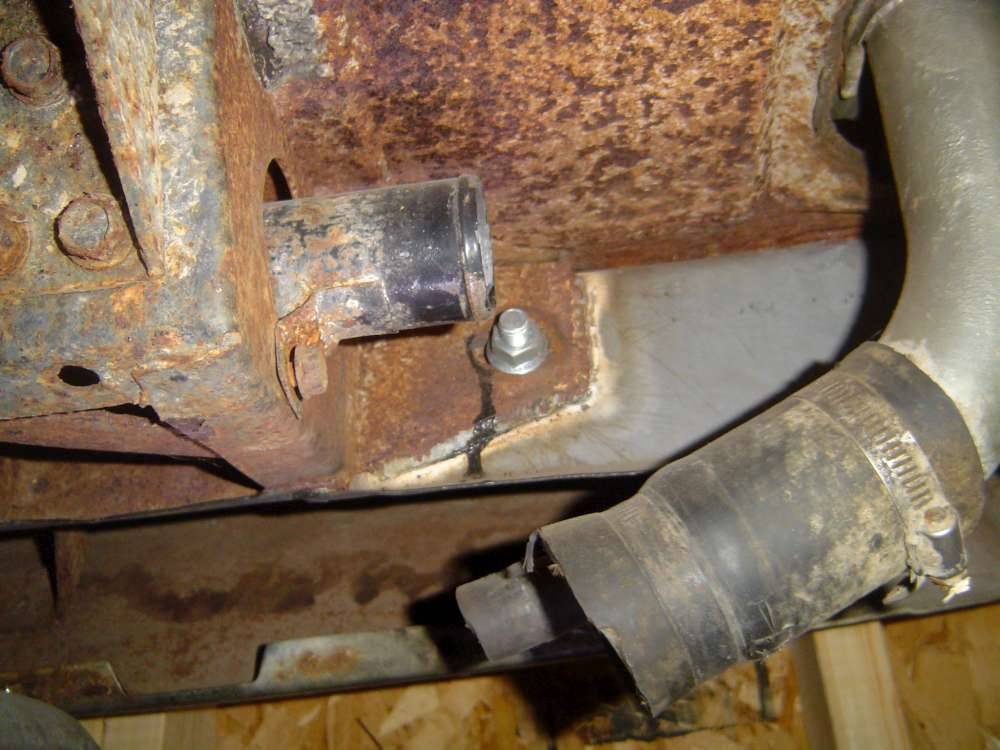

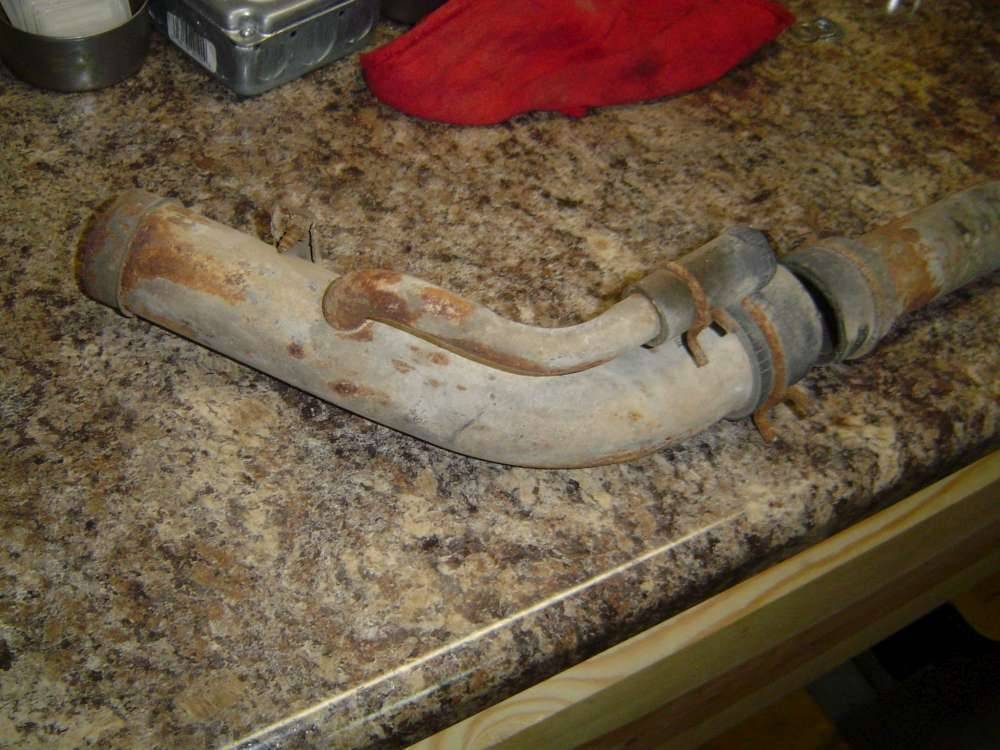

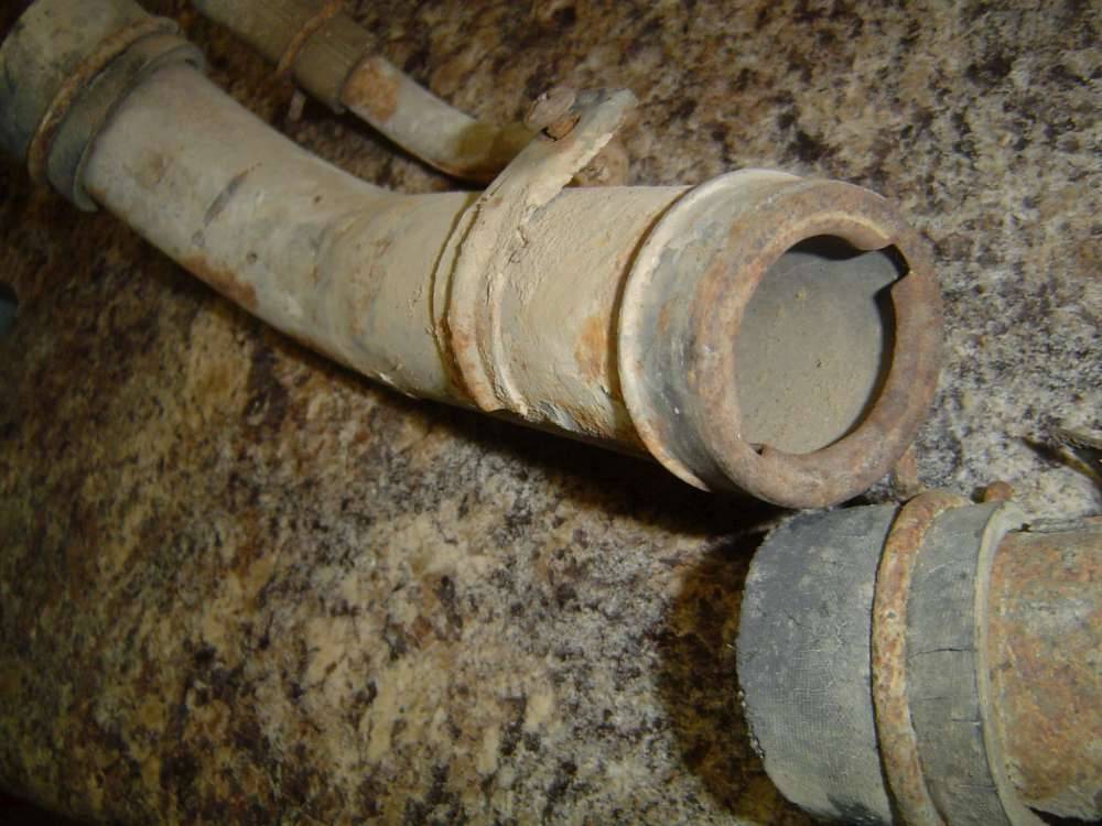

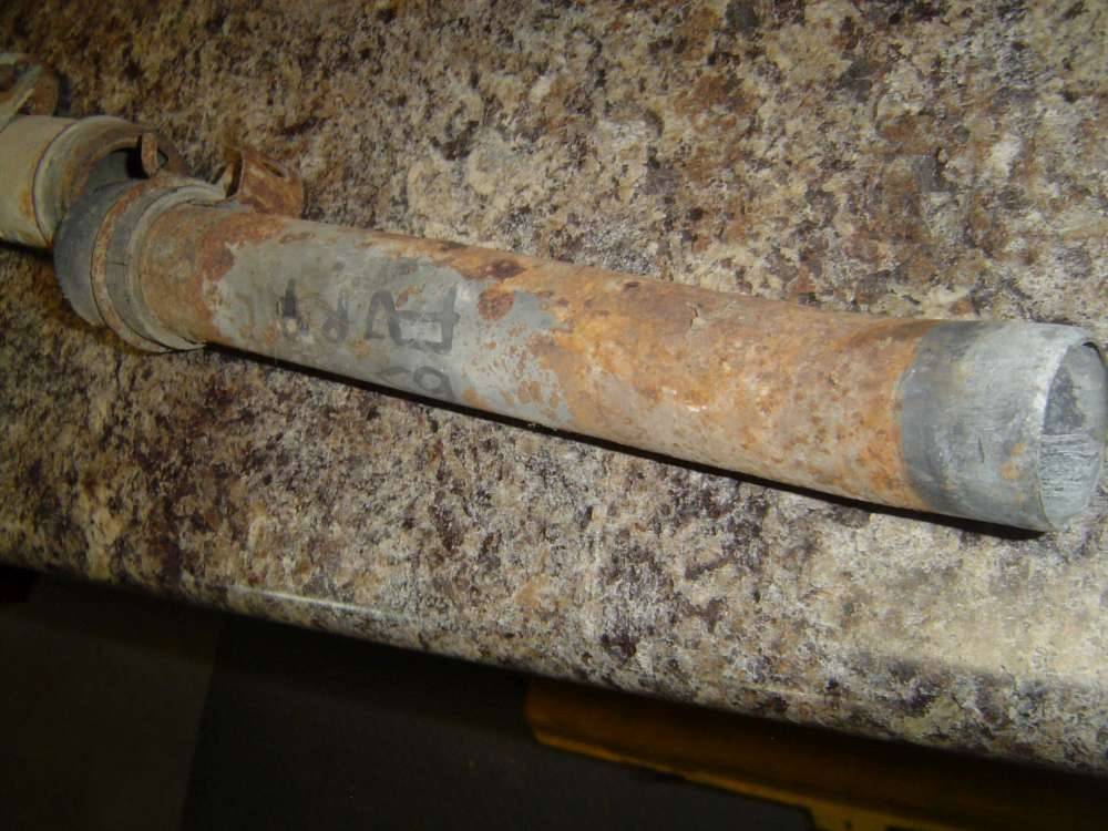

Was just typing a reply myself when a webpage bug wiped out my answer. Will send a PM. Here are some pics, for future reference for anyone that stumbles across this thread. There are 3 pipes involved in this setup, I only have 2 but they are the most critical ones. I have the curved filler tube that the cap goes on, the bigger one thru the frame, I don't have the smaller-dia one thru the frame, but you could use a piece of hose for that. You could fab up a metal tube, I suppose, but it would need the raised edges on the ends to help prevent leaks, if you used a hose you'd avoid that detail. Make sure the hose is protected to not chafe thru, of course....
