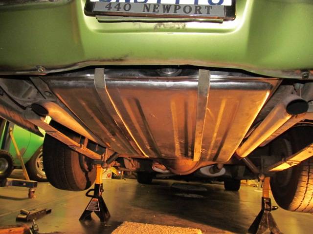

Found some pictures in "Garages" of member "Scott 440 TNT"'s car. The B-body tank is about 3" narrower and 3" shorter, but he said the existing straps fit fine. He mentioned that he should have gotten the sender to match his existing fuel line size. No mention of the particular application, though. Looks like it might be a viable alternative?

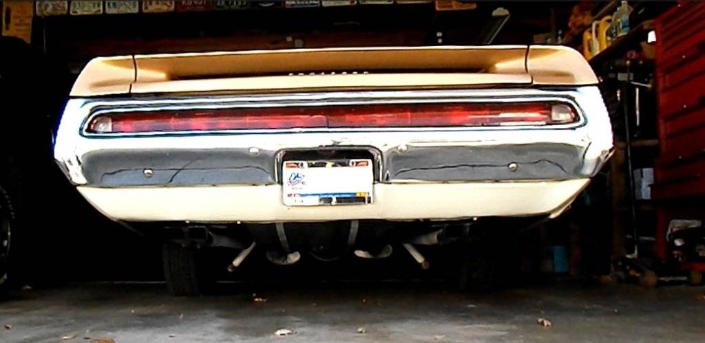

I used a B body tank on my 70 Polara years ago. It allowed me tuck the second tailpipe between the tank and frame rails instead of hanging below them. So long ago I don't remember what it was from.

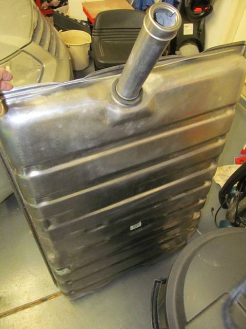

In 2000, there was a posting on some goofy new startup called Ebay for a used "1970 C body fuel tank". I bought it for $70 back when Ebay didn't have a return policy. I still don't know what car this tank is for. The original tank was more wide and flat.
It fits and works but there was a problem. Gas sloshing around over 3/4 full or during stopping, some gas would escape out the vent. I even tried to make the vent line higher and longer. Heavy gas smell. People thought my car was going to blow up. I fixed that by sticking a fuel filter straight up on the vent. No more smell and gas tank still breathes just fine. It looks a little off center and goofy but oh well, I'm OK with it. (Camera was a liittle tilted, sorry)
