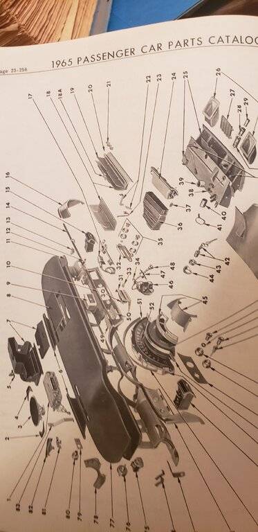

Like Jeff, I removed a dash pad from a junk car and installed it in my 65 without removing any windshields.
I think the parts catalog illustration is helpful in telling what has to come out, it was more than the six fasteners, but it was a while ago. I do remember
the blood...
Mark
I think the parts catalog illustration is helpful in telling what has to come out, it was more than the six fasteners, but it was a while ago. I do rememberView attachment 438905 the blood...
Mark
Thanks for the picture! It was just the six nuts. The foam was stuck to the dashboard a little over the speedometer.
