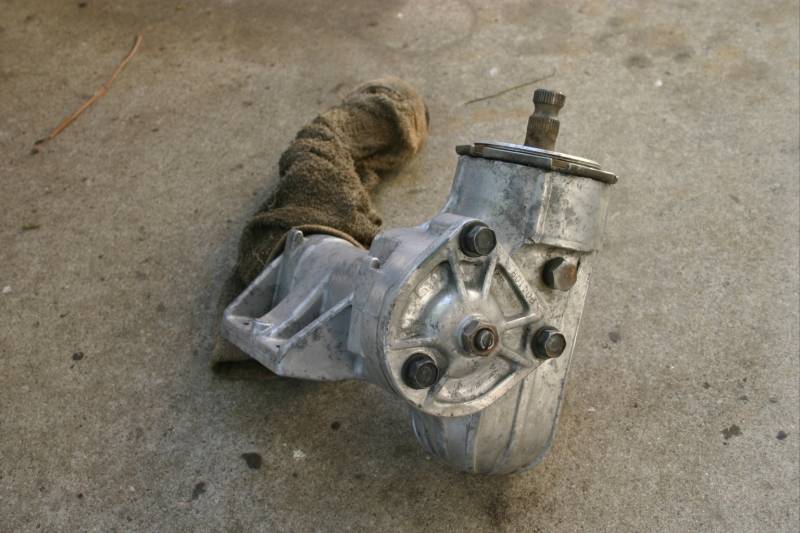

    image.jpeg Manaul steering boxes for C bodies aren't easy to find for a reason.
    I have seen them on highway pursuit CHP cars and a handful of strip model 65/66 furys.
    The columns may be the same,but the colum shaft after rag joint will differ for manual box.
    I believe shaft will be longer,becuase manual box is shorter.
    A 68 or later box will work,but bolts upto colum in different way at rag joint
    If you don't find this post helpful,then maybe you will when your car is up on jack stands torn apart.
    A/B/E boxes will not work on c bodies.
    The pics are of 61 c body boxes. Best describes what im talking about.
    Please somebody correct me if I'm wrong?

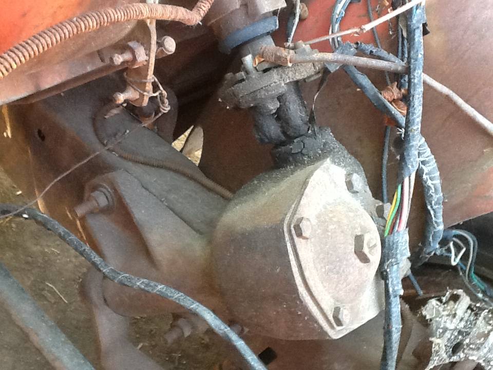

    My CHP car has manual steering and I love it, I had a 1970 D-100 with manual steering and loved it.
    I'm not a big guy and yes low speed maneuvers can be tricky, much can be rectified with driving style.
    I never park in parking lots near other vehicles even in my beaters. When I had a 69 Polara with power steering I still parked in the south forty. In large the turning radius is awful on these cars and it doesn't take much to get pined in a parking stall and require a 20-point turn to get out.
    If I recall I think the manual steering gear on C-Bodies is the same as B-Series vans.
    Alan

    This is the steering gear for my 69, I don't know if it would be the same as a 66.
    Alan
