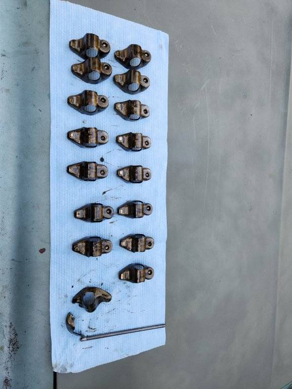

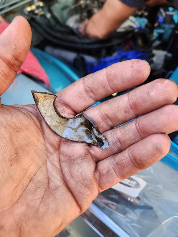

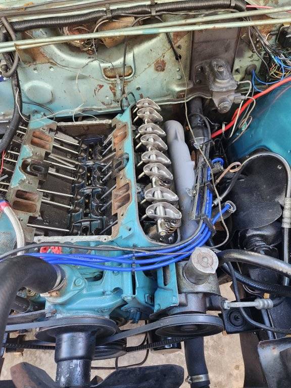

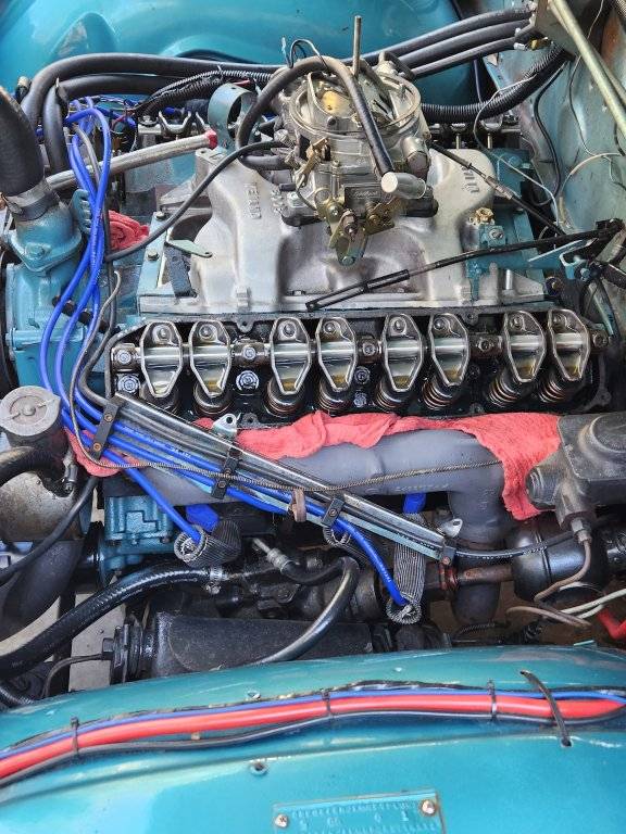

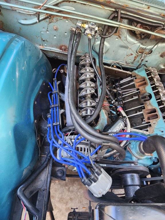

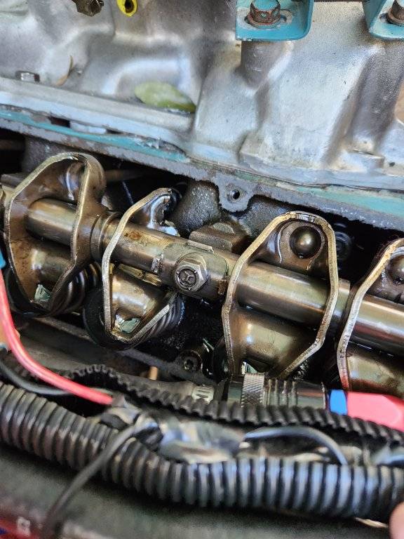

Well I found the problem. I want to replace them all. Wheres a good place to buy a set from that won't break the bank...View attachment 573333View attachment 573332View attachment 573331
I have never seen one fail like that. Usually the pushrod pokes a nice little hole in the arm.
I would look at the valve and spring for that cylinder just to be safe. Make sure the valve isn't hung up.
IMHO, replacements probably won't be as good or strong as your used originals. If the spots where they contact the valve tip look good, I'd just replace the one bad rocker (again, check the valve) and toss the old ones back on.
FWIW, I've got a set here that has a worn patch where it rides on the valve stem. Perhaps .010" deep.
Yes, it's not failed, but it's also hidden, and one wouldn't know about such wear unless they took them off for some reason.

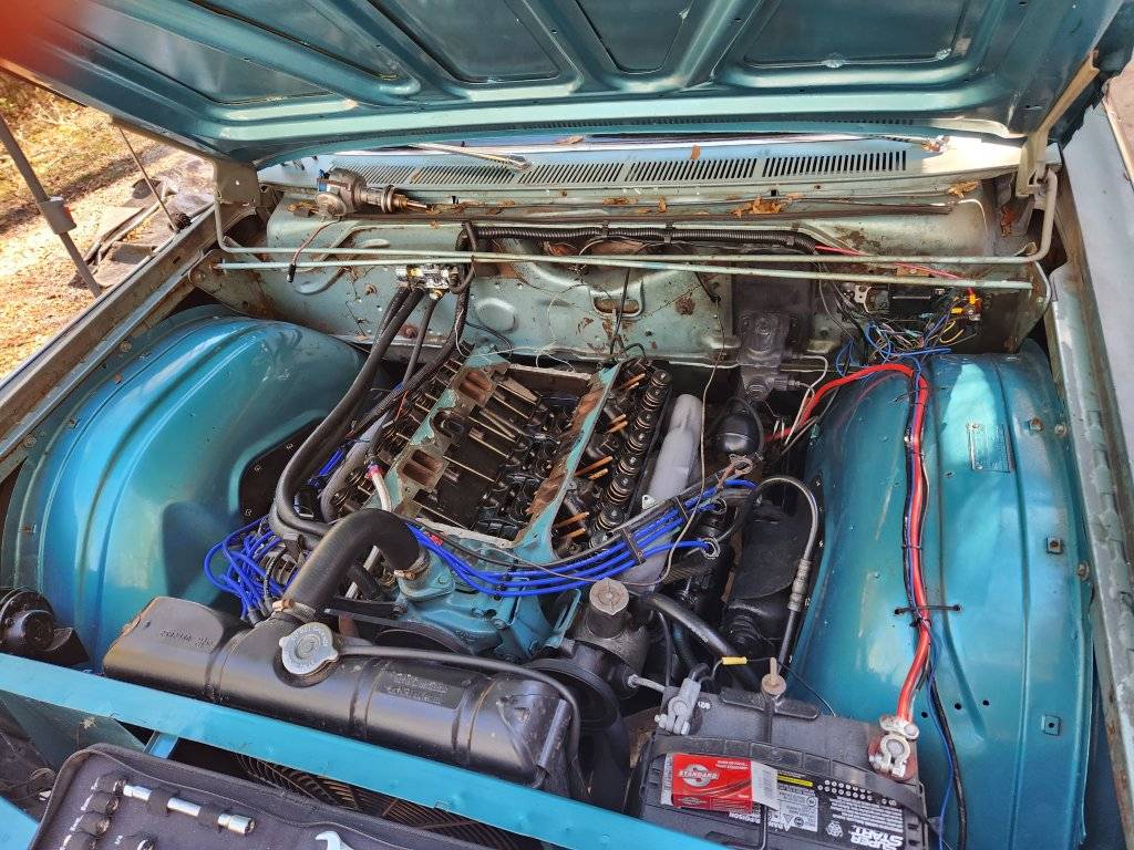

She's back in business, thanks to those that were helpful with their advice.
