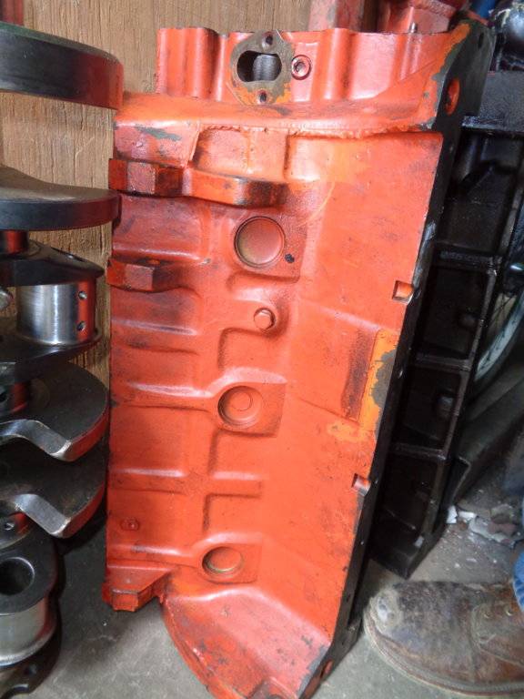

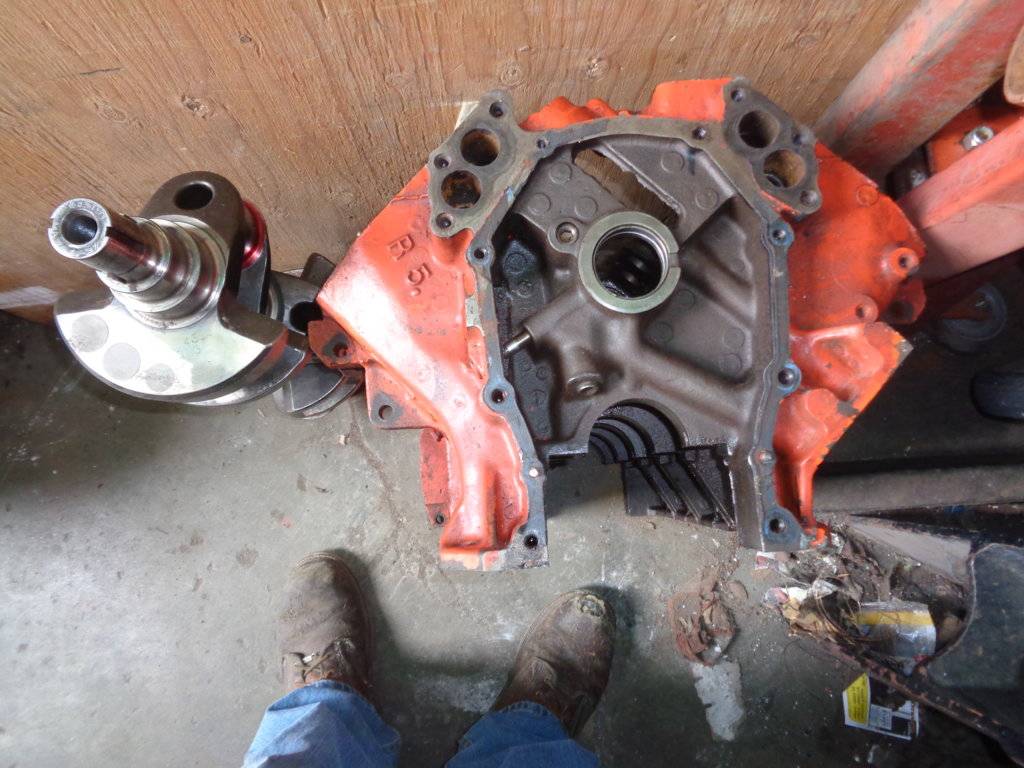

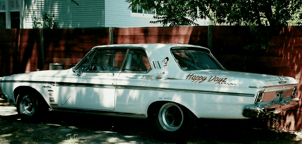

yes it would be sweet , but i'm not holding it up just to have a factory c body dana 60 . i'll ull a d200 or f250 one out and cut it down , thicker axle tubes . be good if it carries the front wheels , lol . i just ran across a ind rb block , it can be bored to 4.5 and still have cylinder walls . i've got a 4.5 stroker crank that = 572 . that engine will need thick axle tubes a 40 spline axles . it should carry the front end , lol . but its not going in my 65 880 rag , just not enough support on a rag for that kind of torque . i do have two 63 furys , both 2dr hts , one is already a max wedge auto street racer , this other can be a 572 max wedge car with a a833 4spd , and of course a thick tube 40 spline dana 60 . it would be hard not to carry the front wheels on that when it leaves , lol .
