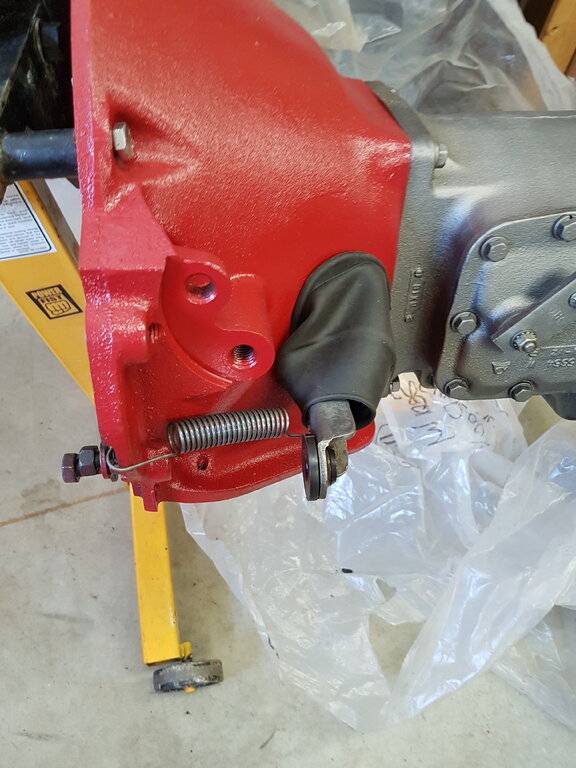

Anyone have a 1967 B and C body 2843234 440 11 inch bellhousing laying around that has the fork pivot in it yet? I'm putting my 67 Coronet back together, originally a 383 4 speed car. It had the 2843234 bellhousing in when I bought it years ago. My clutch adjustment rod is at a 45 degree or more angle. I called Brewers today and he told me that the B and C Body used different pivots. I looked up the part numbers in my 67 Parts manual, and it showed the same part number for both C and B Body for the pivot. Anyone have any ideas? Thanks a lot!
With no boot or return spring:
With boot and spring:
From inside the bell housing:
Hope this helps!
Thanks Ross- I had one of the pivots that Brewers told me to use. I pulled the one out of the bellhousing and they were different. So the 1967 440 11 inch bellhousing used in B and C bodies DO use a different clutch fork pivots. I installed the one I had and everything lined up perfectly. Sorry, I forgot to take pictures while I had them side by side.
