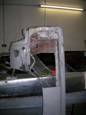

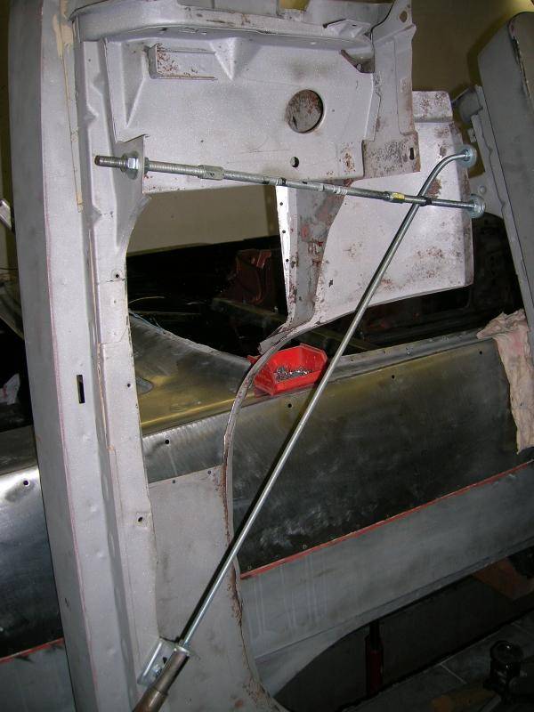

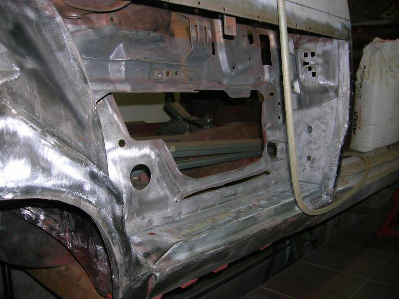

What a beautiful it has been...:coffee2:

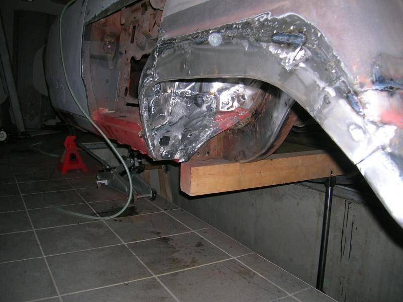

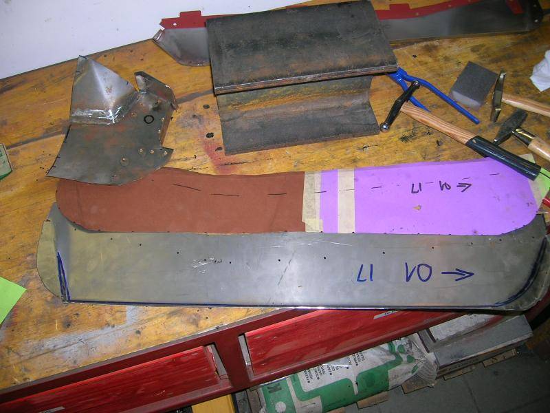

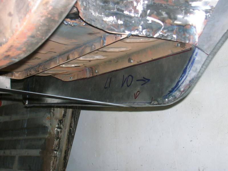

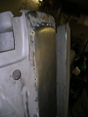

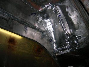

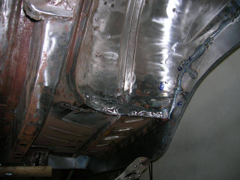

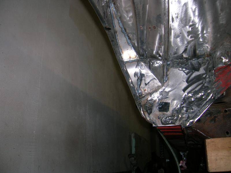

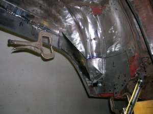

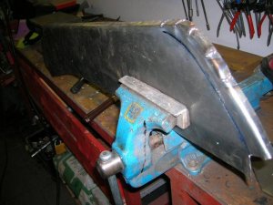

The fenderwells are done, the trunk extension panels are the next in line(selfmade what else...)

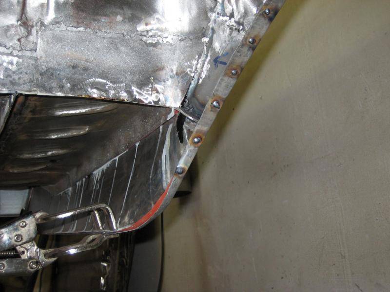

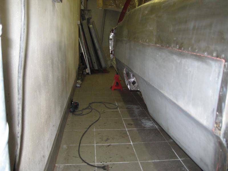

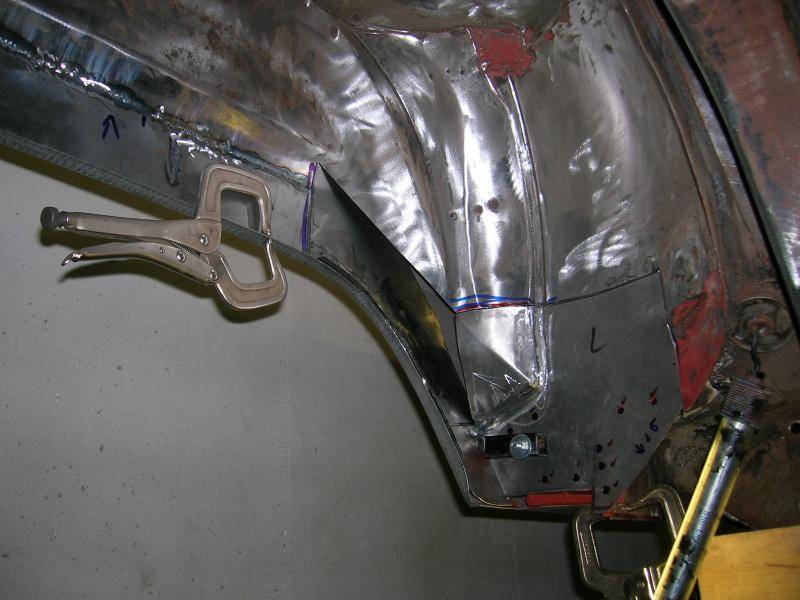

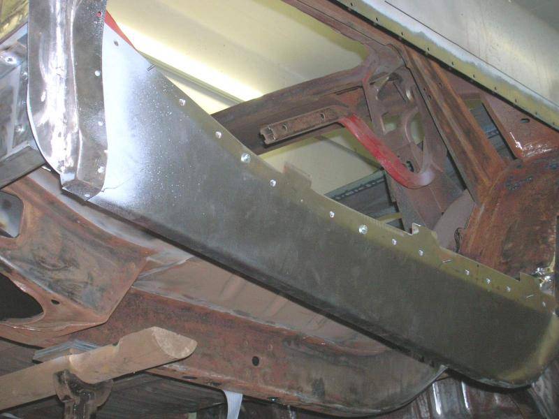

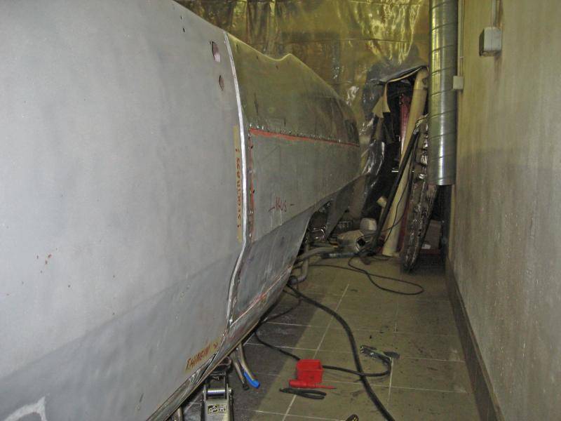

Quarter extension panels: what a job under the car...DSCN2045.jpgDSCN2101.jpgDSCN2154.jpgDSCN2157.jpgDSCN2159.jpgDSCN2162.jpg

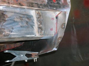

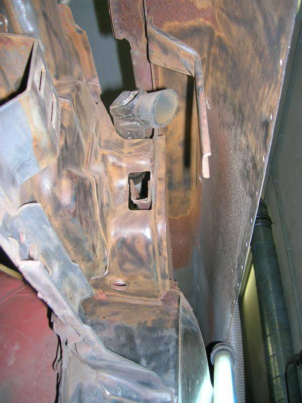

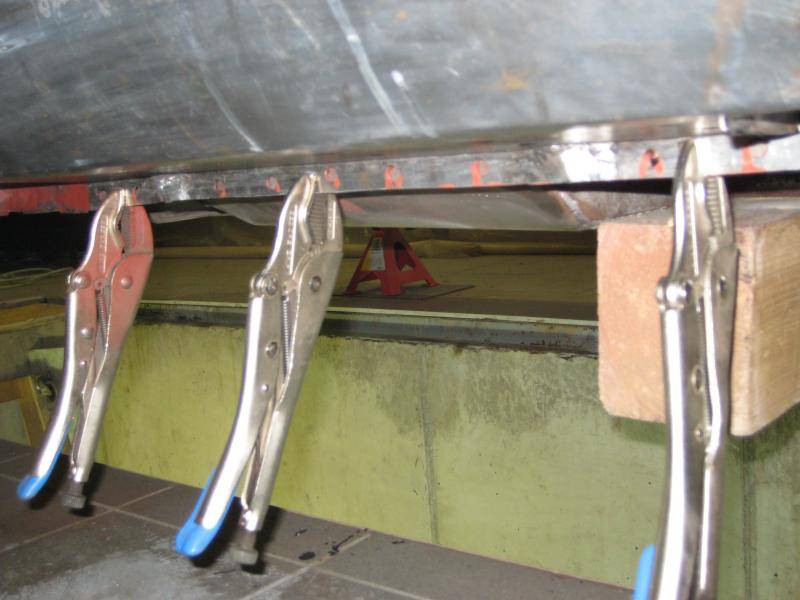

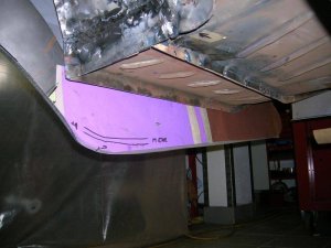

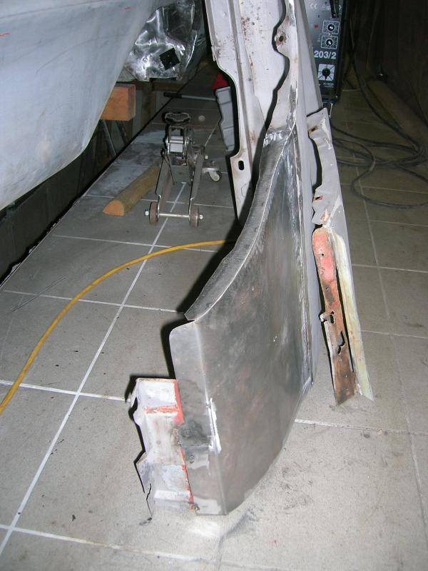

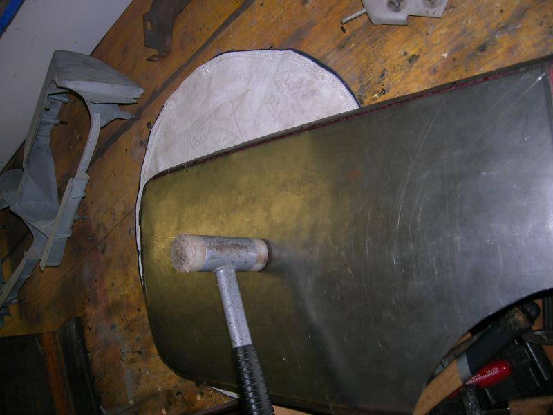

Front fender left...what a long lasting job....
replacing the bondo styled section, with a steel panel
DSCN2280.jpgDSCN2281.jpgDSCN2282.jpgDSCN2284.jpgDSCN2286.jpgDSCN2292.jpgDSCN2293.jpgDSCN2294.jpg
short information: the front fender from a 67 and a 68 fury are looking similar,
but they have another mounting brackets for the headlight-bezels, and the front lower
section is also different.
I want to be you when I grow up!

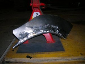

Hand formed panels the old craftsman style way.
Beating a panel into a form is a skill long forgot.
I'm sitting here absolutely in awe.

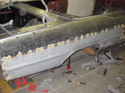

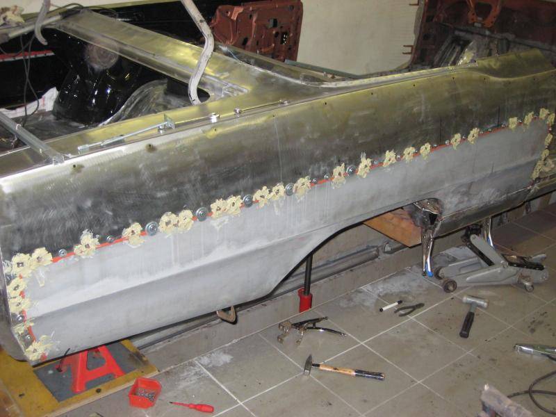

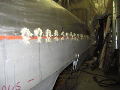

welding the quarters into place - a long lasting procedere, to get them straight onto it
We were just tallking about this in another thread. What's going on here? What are all thos blobs?
attachment.php
Looks like a heat resistant material to prevent warping. Or at least that's what we used back in the day.
the "blogs" are an especially paste for heat transfer, to get the panels straight onto the body.
i applied this at each welding area.
