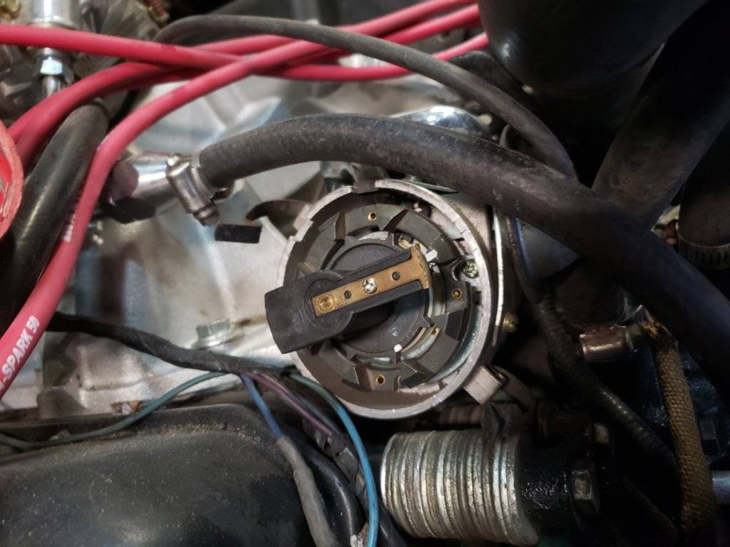

  14. brunickw
    brunickw New Member
    Messages:
    16
    Likes Received:
    7
    Joined:
    Aug 7, 2019
    Location:
    klamath falls, or
    Ok so I got the cam broke in and new exhaust on it, I have the timing set 12 degrees at idle but it's at 40 degrees at 3000 rpm. So I need to adjust the advance down to about 36 degrees right? How do I go about doing that in this distributor? I tried playing around with it but no luck.
  15. brunickw
    brunickw New Member
    Messages:
    16
    Likes Received:
    7
    Joined:
    Aug 7, 2019
    Location:
    klamath falls, or
    I pulled the rotor off and there was a screw and snap ring under it. But the guts still wouldn't come out.
  16. brunickw
    brunickw New Member
    Messages:
    16
    Likes Received:
    7
    Joined:
    Aug 7, 2019
    Location:
    klamath falls, or
    I also tried taking the screws out of vacuum can.
  17. Mike66Chryslers
    Mike66Chryslers Well-Known Member
    Messages:
    683
    Likes Received:
    321
    Joined:
    Apr 28, 2012
    Location:
    Ontario, Canada
    I've never seen a dizzy like that. You said in your initial post that it is a Pertronix unit. Do you have the manual for it? Looked on their website for a PDF copy?
  18. Ripinator
    Ripinator Senior Member
    Messages:
    4,401
    Likes Received:
    2397
    Joined:
    Jul 31, 2013
    Location:
    Germantown, MD
    I would drive it around a bit and see how it runs. If it doesn't ping, it may be yer engine is happy with a total of 40 degrees. If it pings, just retard the distributor in small increments, until the ping goes away.
  19. brunickw
    brunickw New Member
    Messages:
    16
    Likes Received:
    7
    Joined:
    Aug 7, 2019
    Location:
    klamath falls, or
    Ya I thought it was the pertronix but after messing with it i realized it wasn't. The previous owner had put it in so i dont have the manual or anything. I cant even find a brand name or anything on it. Ya I will drive it around and see if it pings or not. I just thought 40 would be way to high.
  20. Ripinator
    Messages:
    4,401
    Likes Received:
    2397
    Joined:
    Jul 31, 2013
    Location:
    Germantown, MD
    One more thing: I assume you had the vacuum advance disconnected and the vacuum port at the carburetor blocked when you set the initial timing to 12 degrees, didn't you? I say this because some times when I do this, I forget to do that
