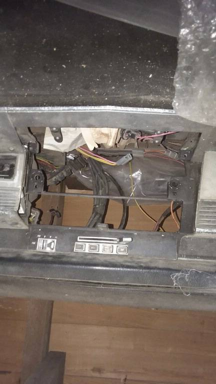

Last weekend I removed the heater box. Fairly simple but the biggest lesson was to remove the front seat (4 nuts under the floor) and that made a world of difference in comfort and suppression of cuss words. Basically, unplug everything, remove the radio, remove the glove box (how the heck do they do this without breaking it like I did?!) and then unclamp the hoses and then remove the 3 nuts on the engine side of the firewall. It seemed like birthing a child but it did manage to get maneuvered out. My heatr was working with maybe a little weaknesss on the blower. I figured it's good to do this as I don't know how long the heater core would have lasted (it's never been replaced).
So now I have a big space to play with but no heater. Coldmaster has a pretty neat Under-dash heater for 50 bucks with 4 ports and a 3-speed blower that I think I am going to use. I looked into combo ac with heat but am told the BTU goes way down because the coil space is split between heat and cool.

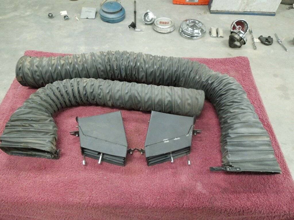

I found some of the parts that I need if I want some of the air coming out of the dash but it is a pain to get the side vents. The reason I have this car (and now two additional C Bodies to prove my love LOL) is because as a kid, my dad had a 2-door Newport with AC. And I do remember playing with those movable vents just under the radio. My Newport is non-ac and has similar-looking blanks in place of the vents. I just might get a kick out of putting at least those center vents on from an AC car....memories... just more of what I get when I catch any of the angles on my car.
And I do agree with you that I would like to put my heater back. I for sire will consider that before making a final choice. :)

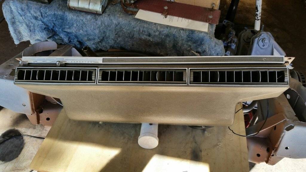

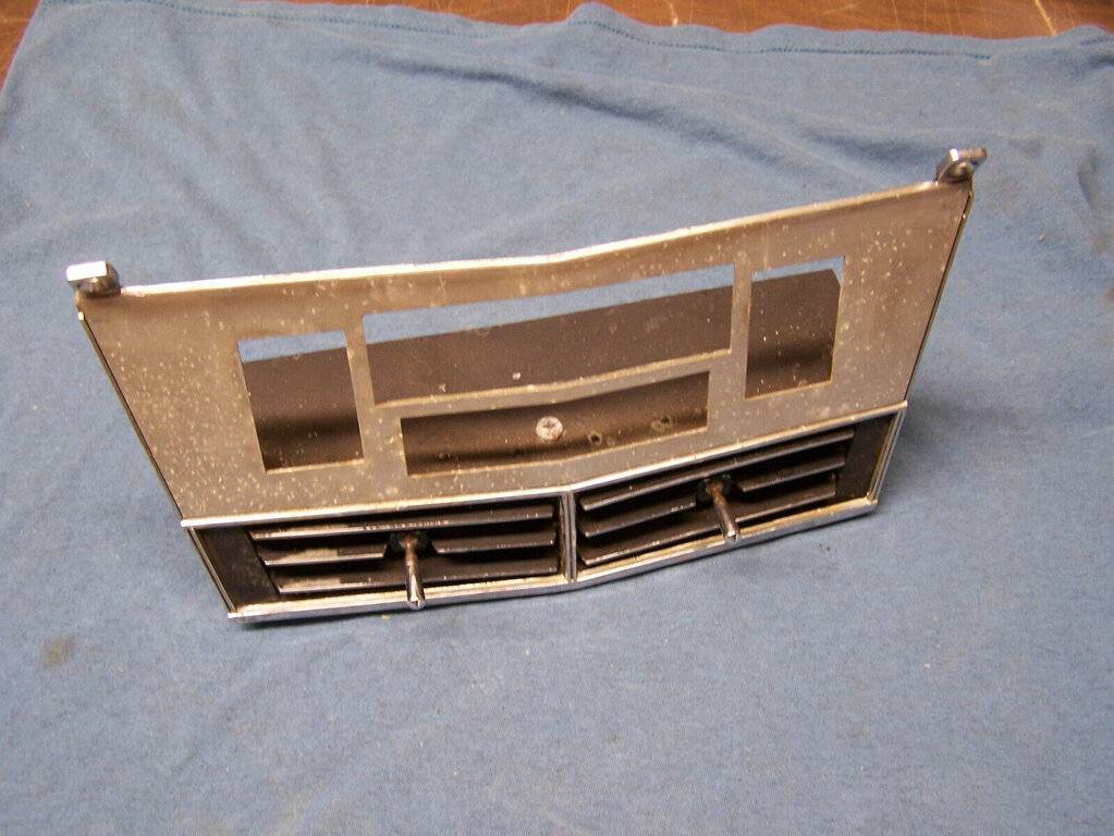

Here are some things I am looking at: Leaning toward utilizing the center vents below the radio from an AC car and using some individual vents along the bottom of the dash on the sides. Preferably putting back my heater box (with a new heater core) but as an alternative, using a combo air/heat system or using a separate heater. I'd like to try and decide this week and get started but the more I look, the farther I get from that simple wish for AC.
For those of you that like the Mark IV: I will be calling Rainbow on Monday to talk about it.. I do want the whole kit with Compressor etc..and the best bracket for me seems to be from Nostalgic. I am excited to cool this car. Budget is a big deal because I may just do it to my 72 Fury sedan and also my Suburban. The wagon has dual factory AC so I will want to know more about how well the Mark IV does with Twostick's wagon :)
The coldmaster kits are for reference so far.. I will be checking out different vendors.
side vent
1968 CHRYSLER 300 A/C VENT OEM w/ 2837025 NEW YORKER NEWPORT TOWN & COUNTRY | eBay
Radio Bezel
MOPAR 1967 68 CHRYSLER THUMBWHEEL AM RADIO BEZEL WITH AIR 67 1968 NEWPORT 300 | eBay
center vents
1967-68 Chrysler New Yorker, Newport, 300 Dash A/C Vents With Hoses NICE Orig. | eBay

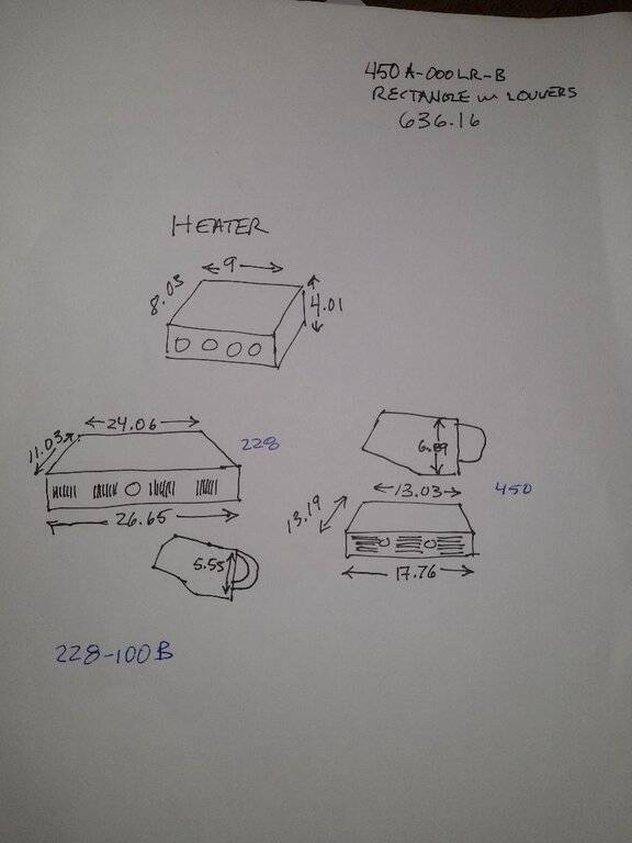

228 coldmaster
A/C KIT UNIVERSAL UNDER DASH EVAPORATOR 22.220BTU 223-100 B 12V W/ ELECTRICAL HARNESS
- A/C KIT UNIVERSAL UNDER DASH EVAPORATOR HD KIT AIR CONDITIONER 12V 450A-000LR-B BLACK RECTANGULAR LOUVERS W/ ELECTRICAL HARNESS
Separate Heater (I am getting one for my pickup 50.00!)
CAR AND TRUCK HEATER 12V UNDER DASH with SPEED SWITCH
Sooooo... I am probably going to get the Vintage Air Gen II super with ac/heat/defrost.. Thank you Twostick for the recommendation
Now, about the dash... I am wanting to try to use the factory dash vents but converting my car seems to be getting too complicated. I now have the side vents and hoses but I am looking for the fron-t-of-thedash trim for left and right. I have been quoted some seriously high prices so that may not happen unless I find a reasonable set. The center radio bezel is easy to find. I have been assuming the face trim was all that I needed but now I found this dash panel showing the cutouts for the vents on the sides. my question is: Did all dashes have the cut-out for ac vents and used different face trim depending on if it is a n ac car? or do I have to worry about making sure my dash has those cutouts in the first place? the more I see the more it makes sense to just use some under-dash vents...and, how hard is this going to be if I decide to do it?

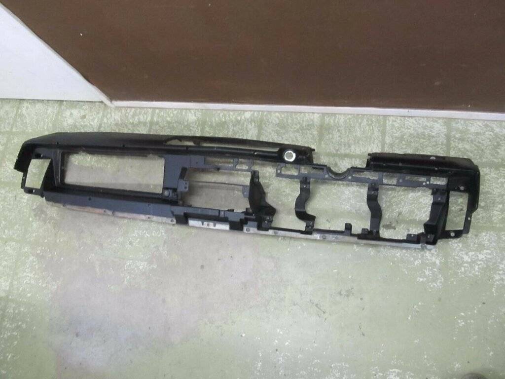

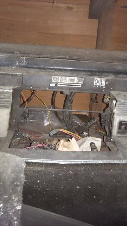

I think the dashes are are the same behind the center trim. I have a non AC dash in the shed. I'll try to remember to get a pick of it. I should be able to tell since my NYer has AC - which I've currently got torn out of the car.

I have purchased an AC dash, heater / evap box, hoses, etc for a 68 Fury and am planning on installing it in a non-AC Fury.
I have a few other projects to tackle before this gets started, but will be looking into it this winter. Your project, I will follow…
i don't know about 68, but the 69 firewall openings are different between a/c and non a/c. might be worth checking out.
The firewalls are definitely different between AC and non AC cars. An AC car has more heater hose connections at the firewall (4 connections, 3 holes, one an oval), plus the high and low pressure freon lines, and a big hole for the blower motor, and vacuum line from the back of the motor to the Heater/AC box. A non AC dash only has 2 heater hose connections and a vacuum line (Fury doesn't even have the vacuum line in 65/66), and no blower motor hole or other line holes.
However, if he uses an aftermarket AC and heat system, it's unlikely that any serious firewall mods are needed other than holes for the freon lines.
