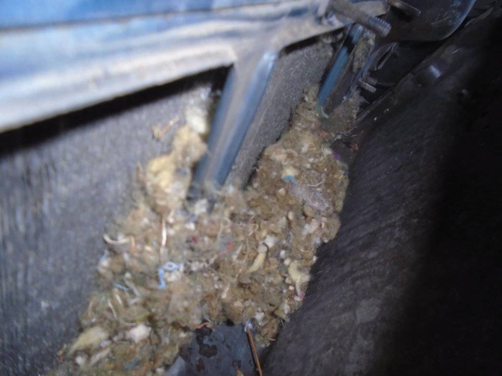

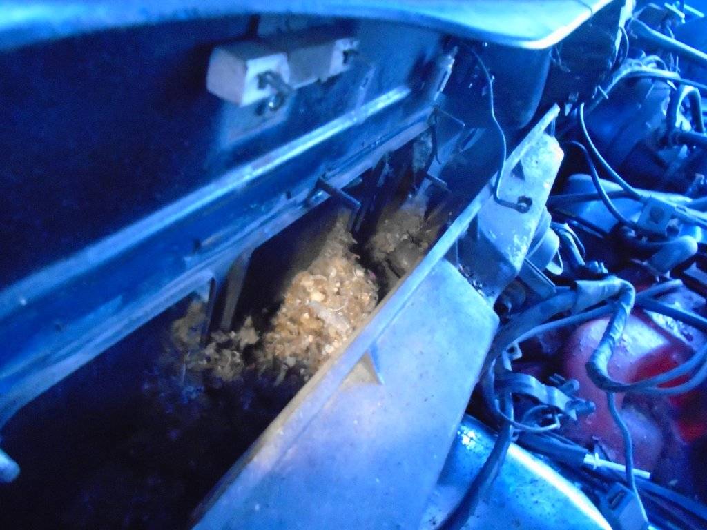

@furous70 is right about rebuilding your heater box. If you can control the air flow, the blower mtr can only produce so much air. I have rebuilt many heater boxes for 69-73 C body cars and properly adjusted they can supply more than enough air. As a caution, measure the amperage draw of the blower mtr. Also check the effort it takes to rotate the squirrel cage on the blower mtr. Another possibility is a partial plugged blower housing courtesy of mice and squirrels. Contact Detroit Muscle Technologies about buying a foam seal kit. See the photo examples below.
