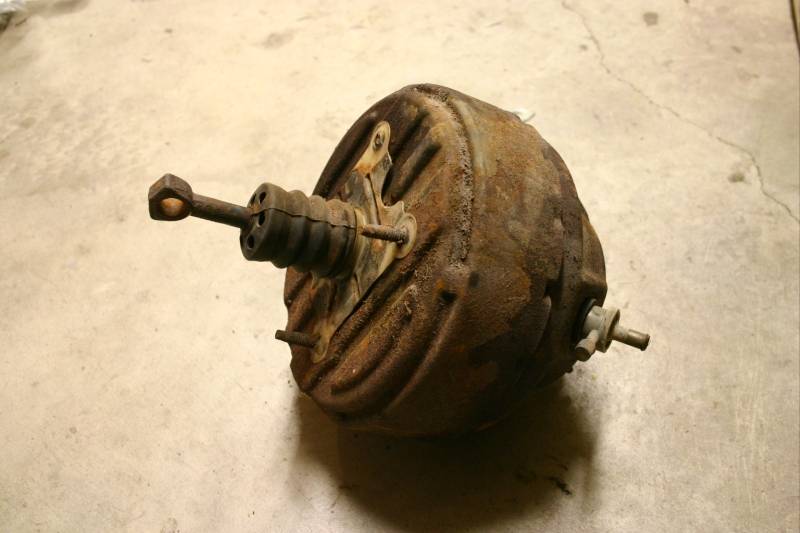

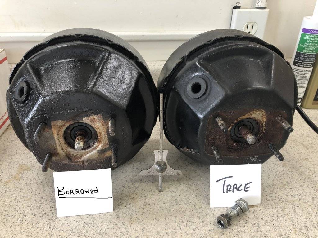

Here's a BEFORE pic. The "borrowed" unit has been rebuilt by Booster since this pic was taken a year ago and is now on a member's car that was being worked on during the loan period. The borrowed unit allowed me to drive the car for the two months, and once my booster came back, I sent the borrowed booster to the Booster folks, and they then sent it back to the owner all shiny (well, semi-gloss) and new.

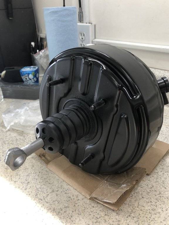

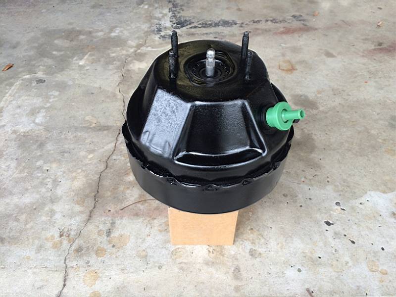

They don't restore the housing, if it has pitting it will come back that way.
Before and after on the CHP car
and the one for my convertible (no before, it was a cleaner core, not originally from the car)

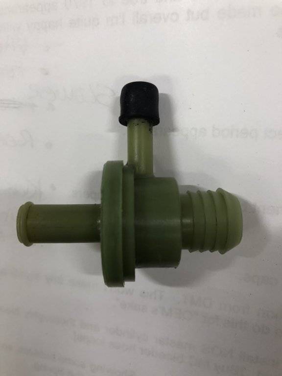

Agree. They blast it and get it as best they can, then shoot it.
Also, the check valve they put in it is a generic item and incorrect if you care about such things, and it's very important if you need the second smaller nipple for cruise or whatever. I removed my OEM check before shipping.
