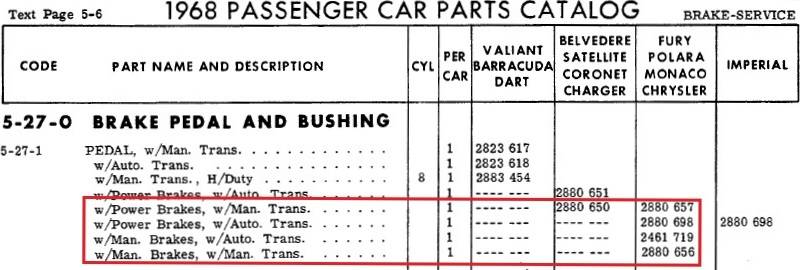

Typically, a power-brake pedal and a manual-brake pedal for a given car are not the same. I'm sorry - I don't have a 1968 parts manual, so I can look it up to be sure.

**Edit: Huh....I guess I DO have the '68 parts book. Pedals are all different. Reference image attached. There probably should be a part number stamped into the brake pedals, but I've never actually looked....
