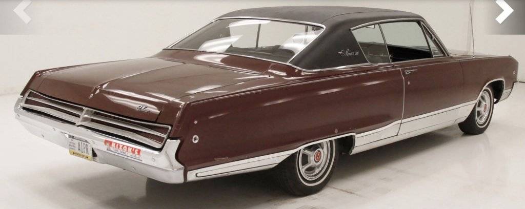

Nice Burgundy Metallic , same as my’68 Polara. Looks like it already has the upgraded 15” tires and the correct white walls.

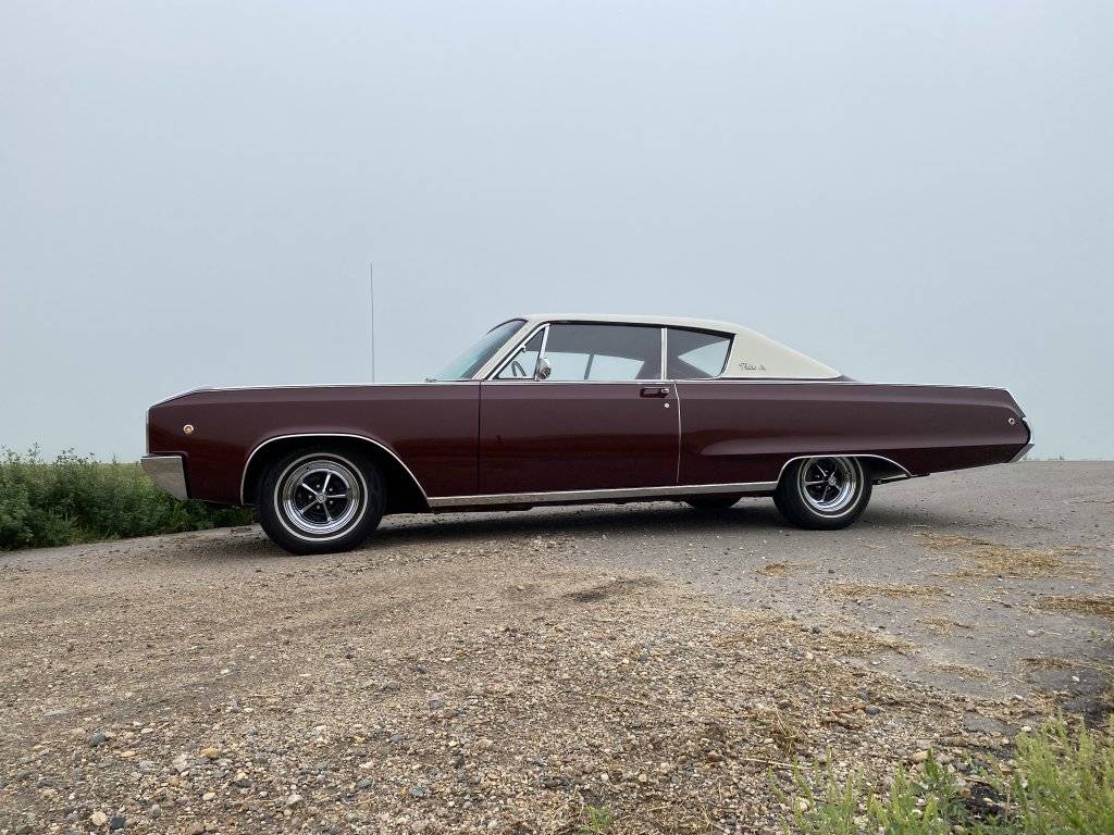

I went with the 25 inch Magnum 500's.
Looks stock, and the 23570r15 tires are 28 inches tall.
Excellent ride and fills out the wheelwells..

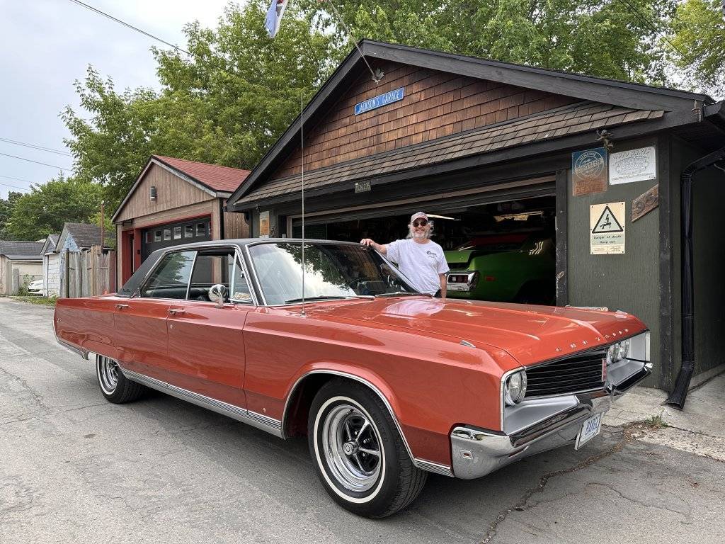

From one 68 Monaco 500 owner to another, nice score. WRT wheels and tires mine rides on 235/75/15s all around with the road wheels and later centers. :thumbsup:
