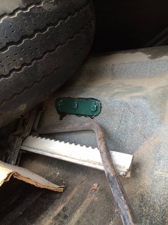

The oil pressure switches are good. Even better is the install of a "crash" or "roll-over "switch. Crown Vics were a good source for a cheap one. They are in the trunk near the spare.
Or buy one new. Painless Performance 80160 Painless Performance Rollover Safety Switches | Summit Racing
I was in one roll-over wreck ('68 Camaro, belonged to a girl friend and she was driving) and the engine was still running after we stopped. I reached over to kill the engine and it kept dieseling for quite a while after I turned the key. With it dieseling, I would bet there was enough oil pressure that it wouldn't trip the pressure switch.
Well, that was a Chevy, you just can't stop one of those.
Yeah, I forgot that Ford used an inertia switch in the trunk to stop the pumps on the EFI cars. Don't know if it would work in a rollover, but I'm sure Ford did the FMEA on that.
Anecdotally, I read somewhere years ago that when EFI was first put on hte Crown Vic copcars in the mid-late 80s, some professional criminals learned that if you slammed the brakes and let the cop rearend you a bit, it would trip their inertia switch and they'd be out of the chase for a few minutes (if they knew to reset the switch, that is). IIRC that was 1-2 years and the copcars reverted to carbed engines.
