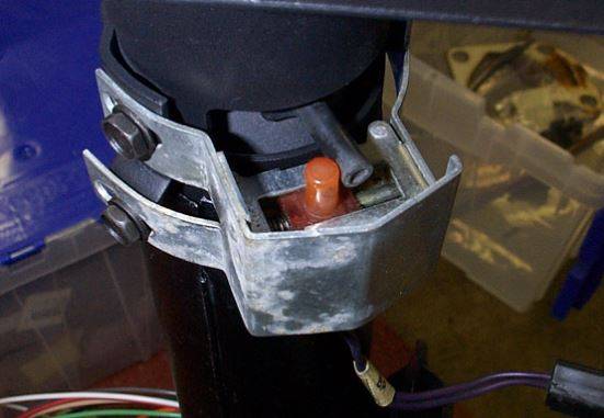

Mine's missing. Looks like attached picture.

Look where the column meets the firewall under the dash. It's mounted to the column by the reverse light switch. When the shifter is moved, the column rotates and this lever slides the switch to activate the lights. See attached picture.

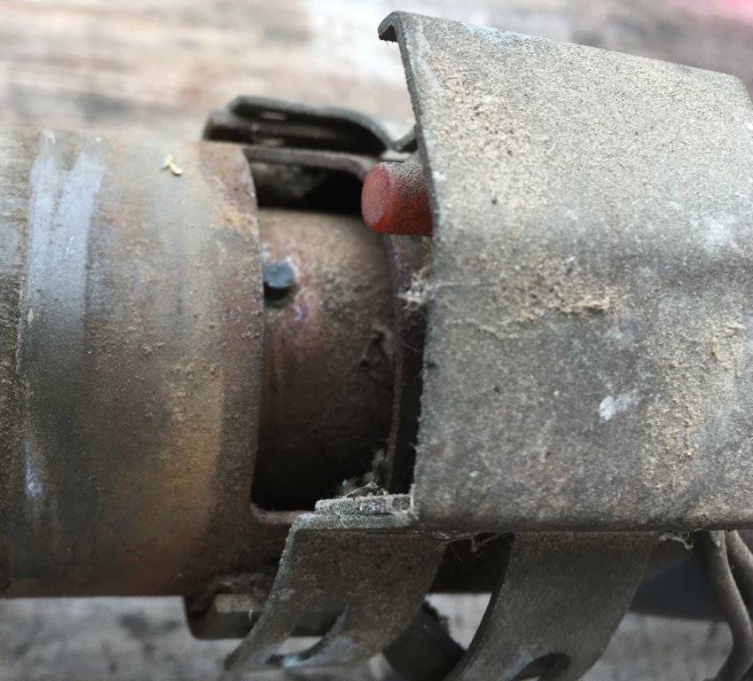

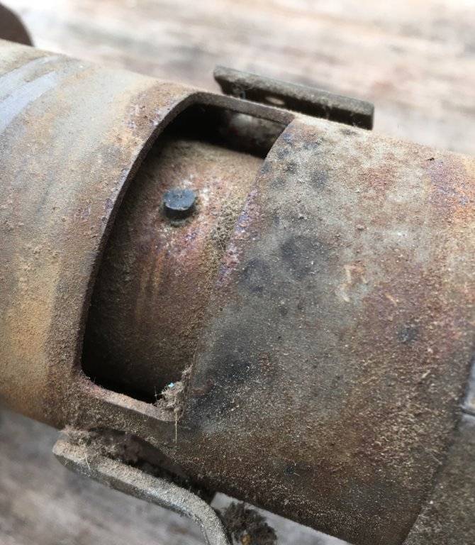

View attachment 147188 View attachment 147189 I took the column out. This is what I'm seeing.
Hi, just replied to your PM. The lever is gone/broken off. That's what's left of it still in the column. Picture in post #3 is what it should look like if it's there. Picture in post #1 - the part that sticks out to the right of the curved part - that's what's still left in the column pictures you posted.

Suggestions on fabricating a new finger on the column?
Some guys have suggested a bolt/screw right into the column (I believe 12-24 thread). Mine's totally gone so I'm going to try to find one, even if it's broken, so I can use for dimensions / as a pattern.
